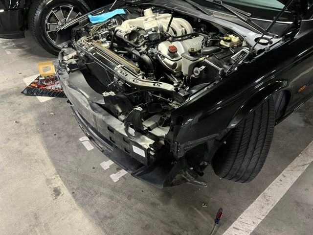

Well I wasted no time and tore into this last night. Ended up pulling the bumper off as well, as I plan to retrofit a pair of factory HIDs I pulled recently. I think it was a little easier for me by pulling the entire front bumper off, I was also able to clean everything as well.
Link above was awesome! Super helpful.
Fun fact….naturally once I get it off the blades in fact do spin…but I’m pretty sure it wasn’t working regardless. My guess is the control box is shot. I have a replacement on the way.

Good catch, you are correct. The fan is not frozen, but does not move with 12volts applied. Thankfully I didn’t tear this all apart for nothing. LOL…I mean running the A/C on full blast on a 90 degree day and not hearing a fan or feeling a ton of airflow kind of gave it away for me. But I was feeling the back blades that do not move instead of the blades themselves.

Like Karl said do a bench test to verify failure. If it passes double check the plug in at the harness for power. When i replaced my radiator i found that paticular plug very corroded when i unplugged it. I have no idea how it was getting power up to that point. Nice tactic by taking the bumper cover down. You can get a good view of hoses and such. Even the sway bar bushes
