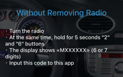

It's a Ford Europe 9000 radio, once you have the serial number the code can be determined, like from here http://www.pumapeople.com/decode.php
You can get the serial number from the radio without removing it.

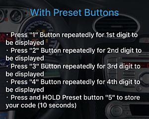

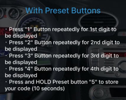

Entering the code this way
