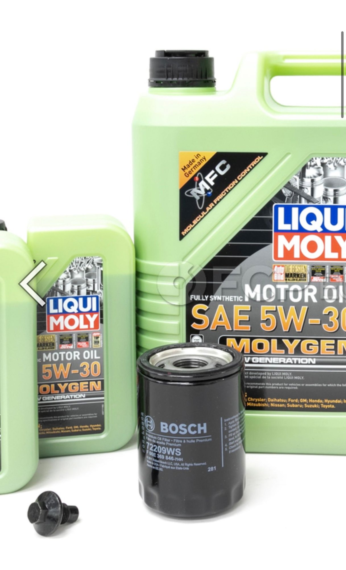

@MDZJaguarSTR, what oil filter are you using?
Old Feb 17, 2025 | 03:54 PM
MDZJaguarSTR's Avatar
Joined: Jan 2025
Posts: 115
This black Bosch One? It comes with the Oil from FCP Euro.. could this be my problem???
This one that Comes with Oil from FCP Euro. Says it’s Bosch?
Old Feb 17, 2025 | 03:58 PM
NBCat's Avatar
Posts: 6,068
Likes: 2,983
Use a higher quality filter such as a Jaguar OEM filter, or Mann as they have an anti drain back valve.

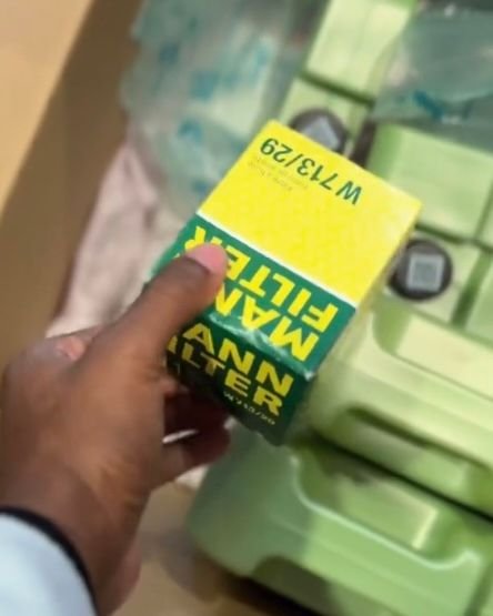

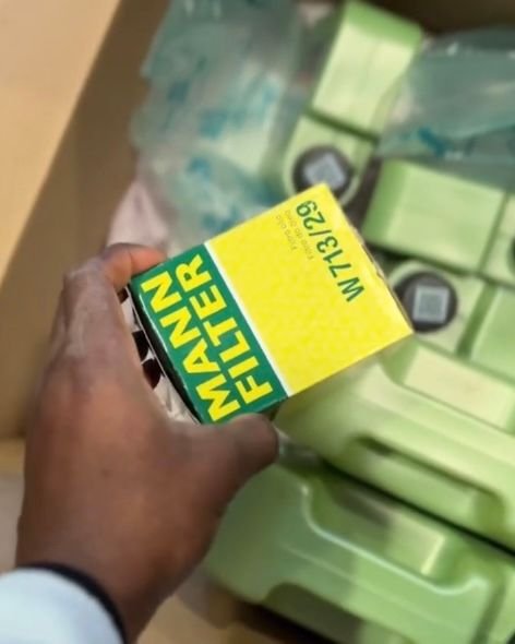

Actually I lied, sorry. Bosch is on the photo but the package delivers a “MANN FILTER”. The pictures are below. I’m sure your advice still stands?

NBCat's Avatar
Posts: 6,068
Likes: 2,983
Originally Posted by MDZJaguarSTR
...I’m sure your advice still stands?
Yes.
