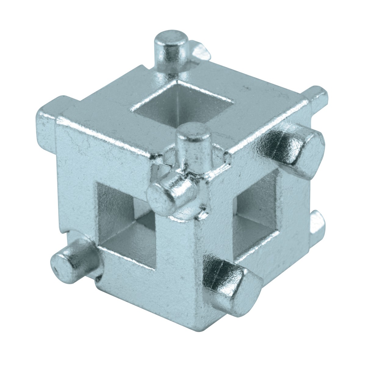

The mystic brake cube

So..The Disc Brake Piston Tool is needed (Cube)....Because of the automatic Parking Brake? ..Thanks

No. You need to rotate the piston back in. Clamp will not do that.

Also the cube is a bit of a pain to use but it will work. If you grind the pins a little it will fit our brake pistons better.
I have started to use the free tool loner program at AutoZone as they have a kit that fits much better and is easier to use.

This is the tool you need. Yeah, the cube might work after you use
every swear word in your vocabulary, and, an extra hour of your time,
trying to get the cube to fit.
I obtained mine at Autozone; they required about a $60 dollar deposit
for two days use and returned when you return the tool; thus, it's free.

I've done the rear pads and discs on mine and never used that funny-looking cube.
I can't recall what it looked like, its been years, but if the pistol just has two tiny holes to twist it back in, then I probably just used needle-nose pliers and turned them in like that.

That will work too, but is an order of magnitude more difficult than the cube. Swear words in languages that not even my ancestors could speak flowed from my mouth.

You have an STR and it doesn't need the tool because it has different calipers, pistons etc. Your STR ones are Brembos that just push in. All the others need winding in. They will not push in.

No Issues. Rear Brakes & Discs Installed. The Cube tool not needed. The piston easy to turn according to my mechanic.
