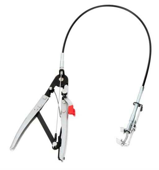

The tool shown above is the real key.
If you try to replace all the factory hose clamps with the old worm drive style you will find that some are in an area that you just can't get a screw driver in to operate the clamp.
I know as that was my plan originally about 5 years ago. As I got deeper and deeper into the engine this became VERY apparent!
I finally got the right tool and it made it 10 times easier. There is no room to work so the remote cable lets you slide into spots you don't have any room for your hands and you can't see what you’re doing. Plus it locks into whatever position you want. This holds the clamp open until you can position it properly. Then when the clamp is released it snaps into position so there is little time for the clamp to move.

I would advise to just use the standard Jaguar clamps. They are much easier to install and having just replaced 20+ hoses I've not experience any leakage. I only used jubilee clamps on one hose and only because it was an aftermarket hose with a larger outside diamter.
You will want the special tool in any case to remove the existing clamps. My first tool was purchased via Amazon and broke pretty quickly. My second tool was purchased from Summit Racing and is more sturdy. Keep in mind that almost all Jaguar hoses come supplied with new clamps and they are held open with a yellow disposable plastic clip. In many cases you can install the hose and twist off the plastic clip and the clamp is set. With the jubilee clamps you will spend more time trying to tighten, and after installation there is always the sharp tail edge of the clamp to cut your hand when doing future maintenance.

The red handled tool from Amazon broke very quickly. I finished the job with this tool.
http://www.summitracing.com/parts/wmr-w80656/overview/

That's a much better tool for about twelve of our Great British Pounds.
Just found it here and indeed, it is £12.61
US PRO Extra Long Reach Heavy Duty Hose Clamp Pliers with Flexible 600mm Wire 18 - 54mm US1729
