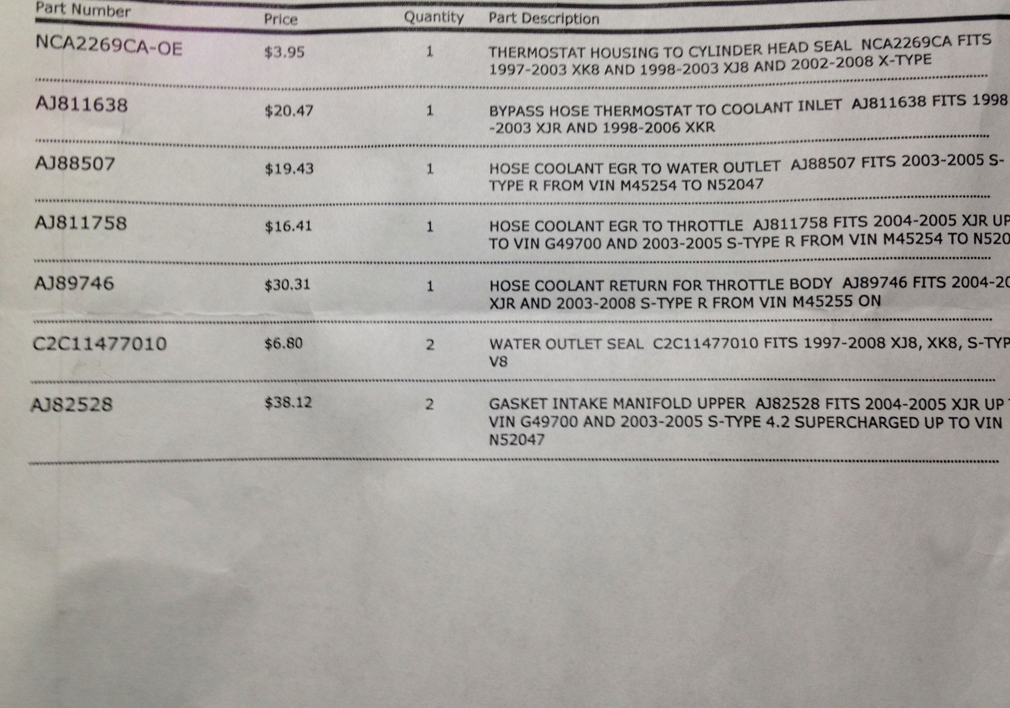

thats looking really good .
its a big job alright !
btw yes there are two ways to access and remove / re-fit the rear supercharger bolt.
i always remove the supercharger rear manifold to expose it too.
i just finished my friends 02 STR valley pipe job last night .
it took two full days . evenly split in-to dis-assembly / parts cleaning / re-assembly .
it was familiar work though .
i only required these parts here - plus antifreeze , sealers ect .
