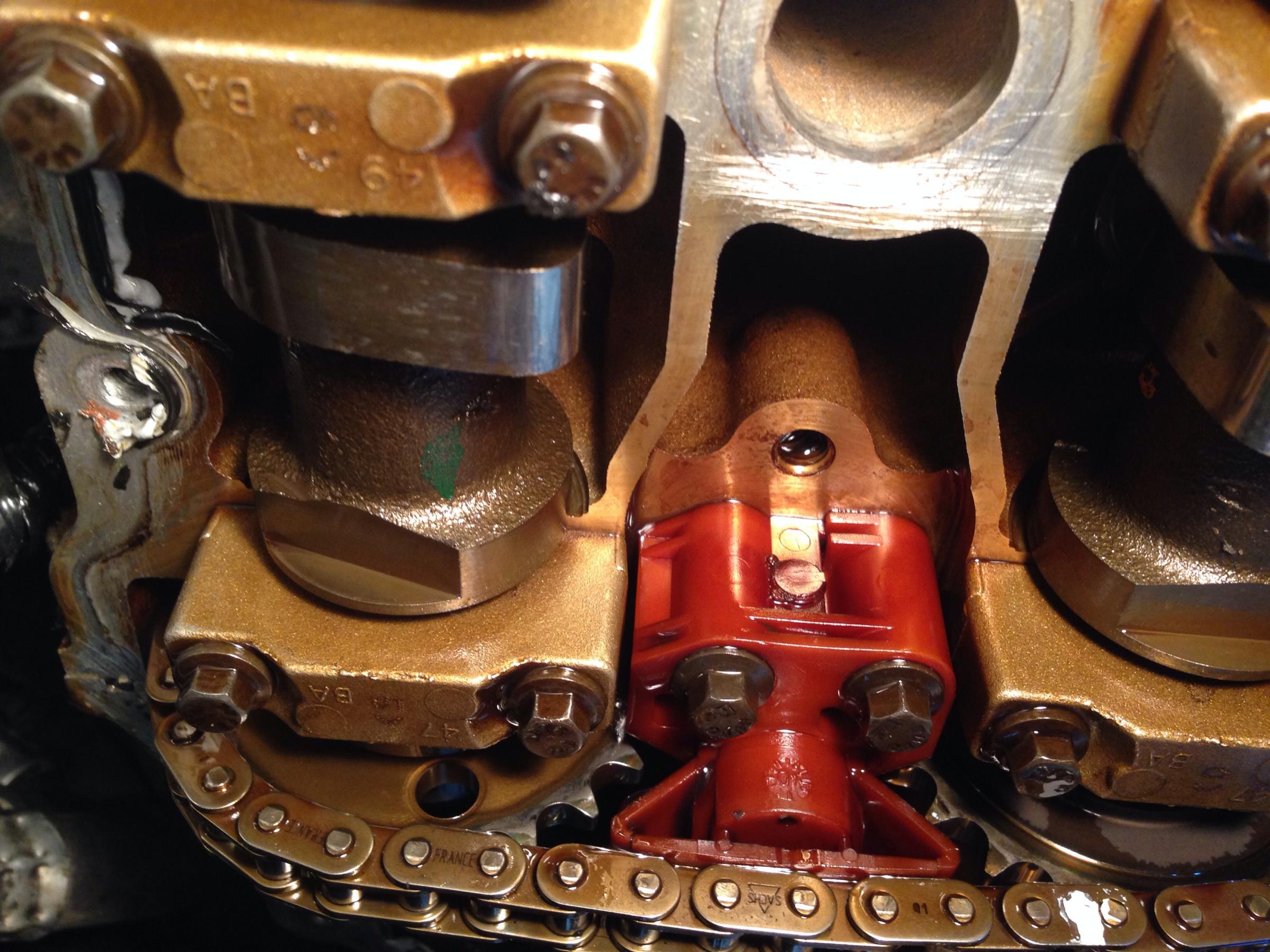

Originally Posted by NBCat
If all other options suggested by other posters have been tried and exhausted, disassembly and reassembly with timing set correctly on both cylinder heads.
I'm going to upload picture of right cam bank alignment. Intake cam shave shaft flat level with the deck, exhaust cam seems to be off by about 12°-15 degrees.

Picture of exhaust cam flat out of alignment , is this enough to cause misfire?

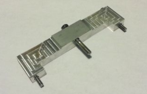

It's off. I don't know if you have seen the proper cam alignment tool but it's just a flat bar that bolts across the flats while you assemble everything else. You really can't do it right without locking the cams down.
You have been very lucky that the valves have not smashed into the pistons as it looks like you are most likely one tooth off. Count your blessings and change all we have talked about. It's a requirement, not an option!
Here is the tool. You can even rent it.
303 530 Jaguar Lincoln Ford V8 Camshaft Locking Tool Purchase or Rental | eBay
Attached Thumbnails replacement engine and misfires-jaguar-cam-lock-tool.png

Yes, I have the tool and used it on the left bank when I swapped head on used motor. I ASSUMED the right bank, which I did not touch would be ok. I now realize that if you "adjust" the timing on one bank it could affect timing on other bank. Also checked compression cyl 1 185 psi , cyl 2 180 psi, cyl 3 180, cyl 4 195 psi, only a little off , but misfires cyl 2-3. I also assumed that the previous owner had everything in line. that was a mistake. I will install crank lock and reset timing.
yes! 😱

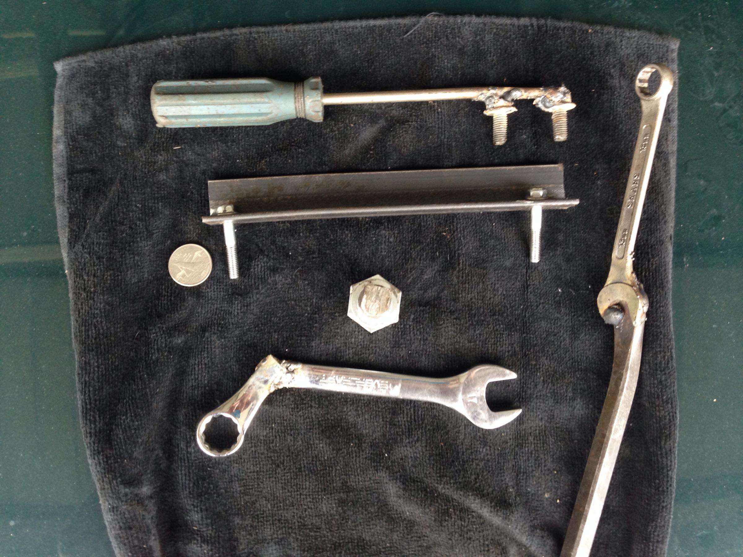

Thanks to all no misfires, no CE else, only had to adjust the exhaust cam, the intake was right on the money. Thanks for all your help .you guys are great my donation is forthcoming.

Default Expensive tools
See attached pics of cam hold down, 3/4
Inch bolt crank pin, cam holding tool, wrench
To tighten exhaust manifold studs that
Extension won't reach and very long ghetto
Wrench to get at the 3000 pesky
Bell housing bolts( realized later that it is easier to
Pull them both at same tome!!)
Have almost $6.27 in these tools so need to
Get my my money back !!
Again, thanks for everyone's help
