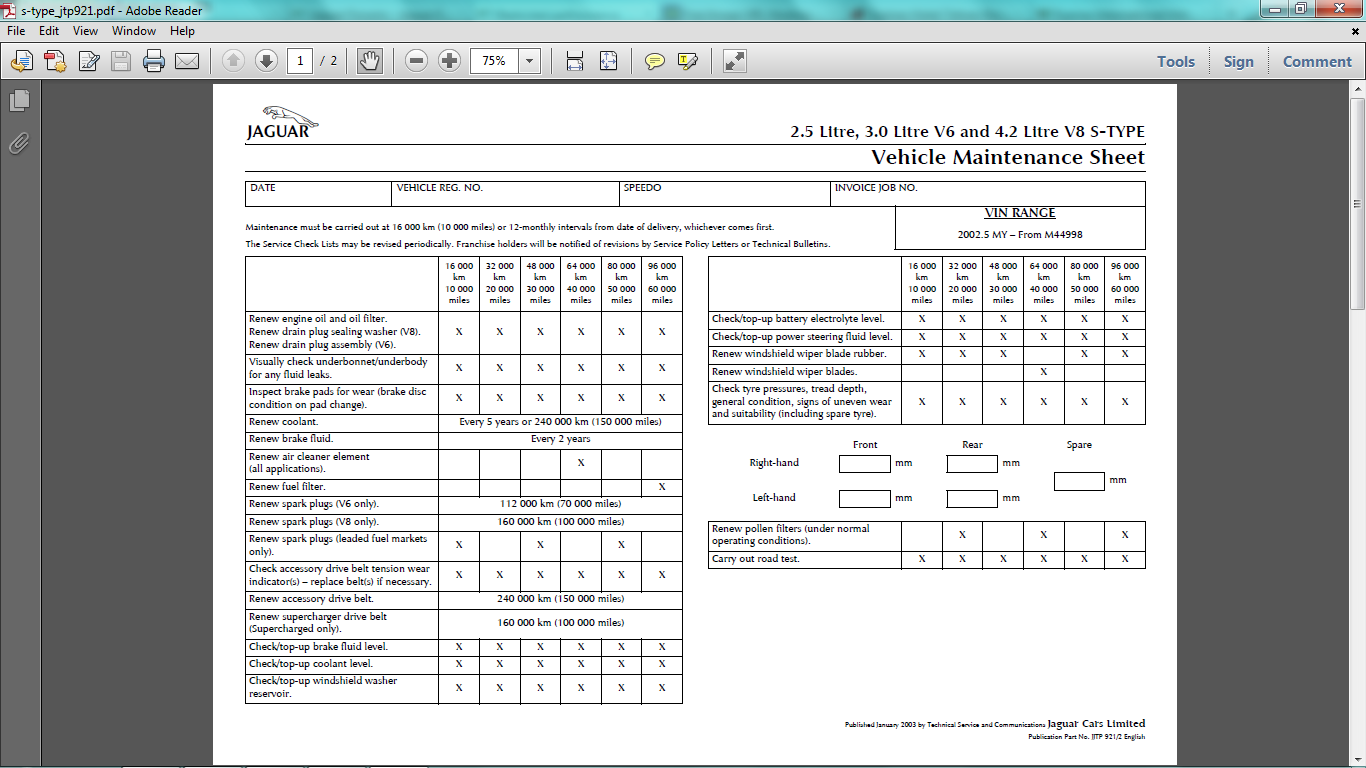

Old Mar 19, 2014 | 07:47 AM
JagV8's Avatar
Posts: 27,546
Likes: 4,924
From: Yorkshire, England
In the service schedule. 3.0 (& 2.5) 70K, 4.x 100K.

Old Mar 19, 2014 | 08:18 AM

Haven't been able to find that. I tried looking under the reference number you provided. If you could upload a link or copy of that, that would be great. Here's all I found.
Here it is from JTIS:
Attached Thumbnails Restricted performance, Engine management Light on-untitled.png
