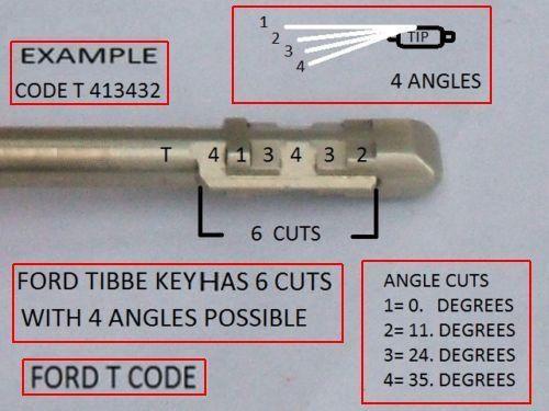

With key code you mean the "cut pattern" of the tibbe key?
I hope you do have a key left, just look at it and "read" it...
If you do not have a key left, there are tools you put into the lock and the tool "reads" the code...
