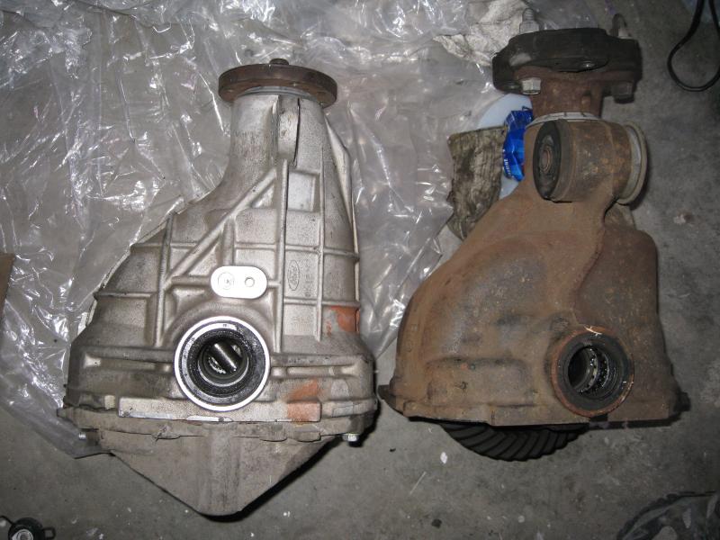

Strength is one concern, although the Gen 1 carriers are pretty heavy duty. I am planning for the eventual day when the car has around 600 hp. (For now the swap has an estimated 430hp with a stock engine.) Based on already having a custom drive shaft in the car, I estimate it will only cost up to $300 more to put in the Mark VII carrier, versus rebuilding and using a stock Gen 1 carrier.
For future reference, my Mark 8 Carrier and S-type Gen 1 carriers arrived today. Attached is an image of them next to each other. The Gen 1 cover fits perfectly on the Mark VIII carrier. The outside seals where the axles go in are the same width, thus as written in the LS forum the Mark VIII carrier with Gen 1 cover will bolt up in the same place on the sub-frame. Therefore a modified drive shaft and front mounting cross bar is all that is required to make the set-up work.
The housing for the Mark VIII is about an inch longer, (Therefore the gen 1 pinion 8.0 wont fit). The MK8 mounting bossed are 1/2" further away from the axle center line.
We should focus on the Gen 2 LSD upgrade in this thread. But if The Mark VIII install goes well, I will plan to do the same thing to my STR later this year.
