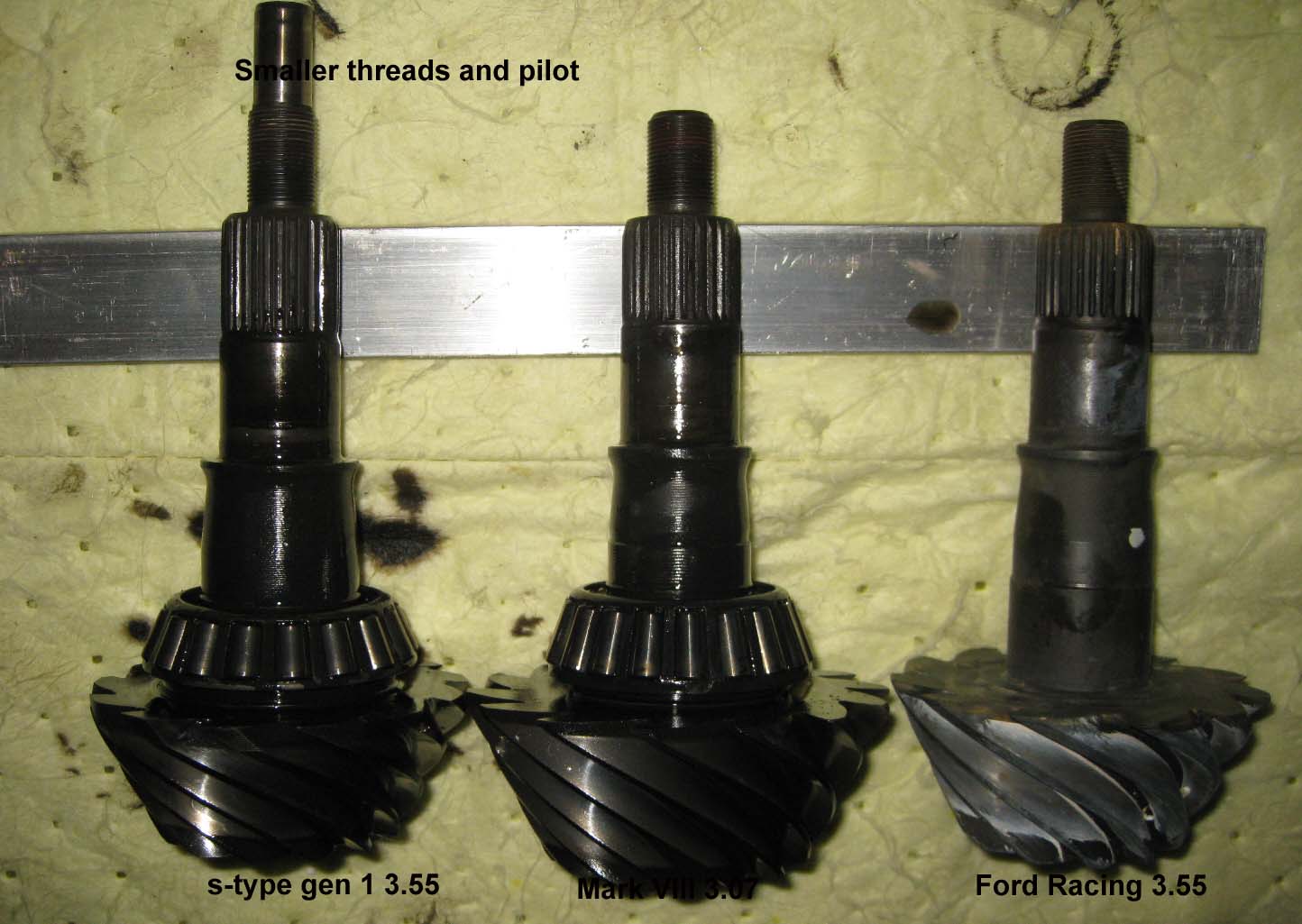

Originally Posted by bfsgross
Joe, I believe I read in the original Lincoln LS thread that the 2.87 bolts up to both our 8" and the 8.8".
I understood that for the Gen 1 and Gen 2 S-type housings. My question was if the 2.87 Gen 2 pinion would fit into a Mark VIII housing.
I may have answered my own question. I put 3 pinions next to each other.
3.55 Gen 1 S-type, Mark VIII 3.07 , and a new Ford Racing 3:55 Pinion.
It looks like a S-type pinion would work in a Mark VIII housing, but I'd have to cut off the pilot and use the S-type smaller nut. - I am assuming that the 2.87 Gen 2/STR gears have the same set-up as the Gen 1.
