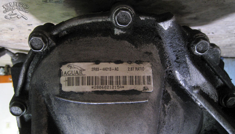

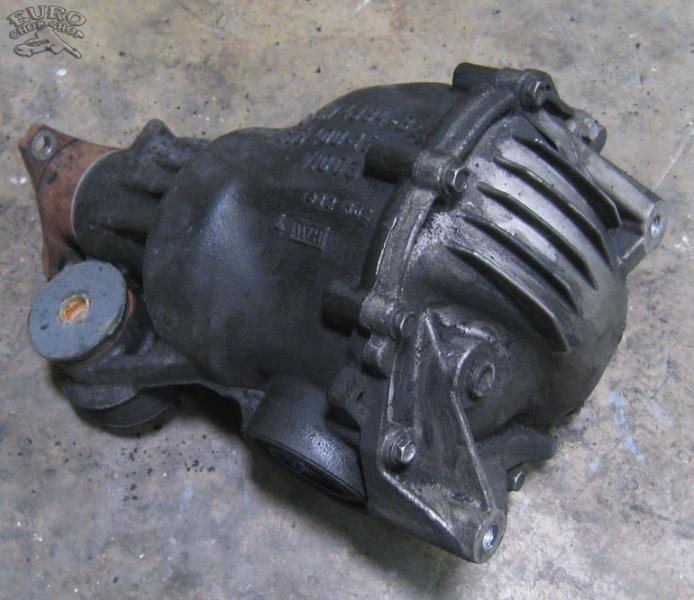

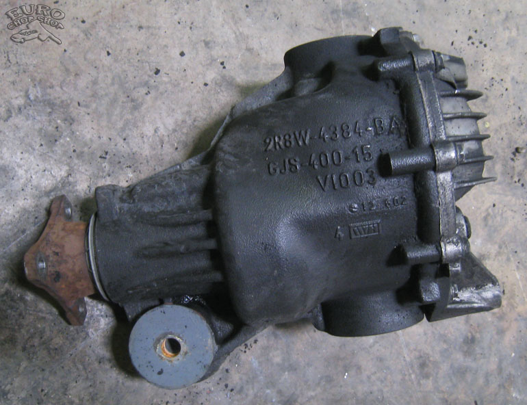

Sorry for all the spam tonight guys, just a little excited about a true LSD and the fact that as bfsgross said, this unofficial jaguarforum group made it happen!
Love pioneering!!
Here are a few shots of the diff we will be owning as of 9:00PST tomorrow morning!
Cheers!
Attached Thumbnails S Type LSD? Lincoln LS Install-diff-1.jpg   S Type LSD? Lincoln LS Install-diff-2.jpg   S Type LSD? Lincoln LS Install-diff-3.jpg
