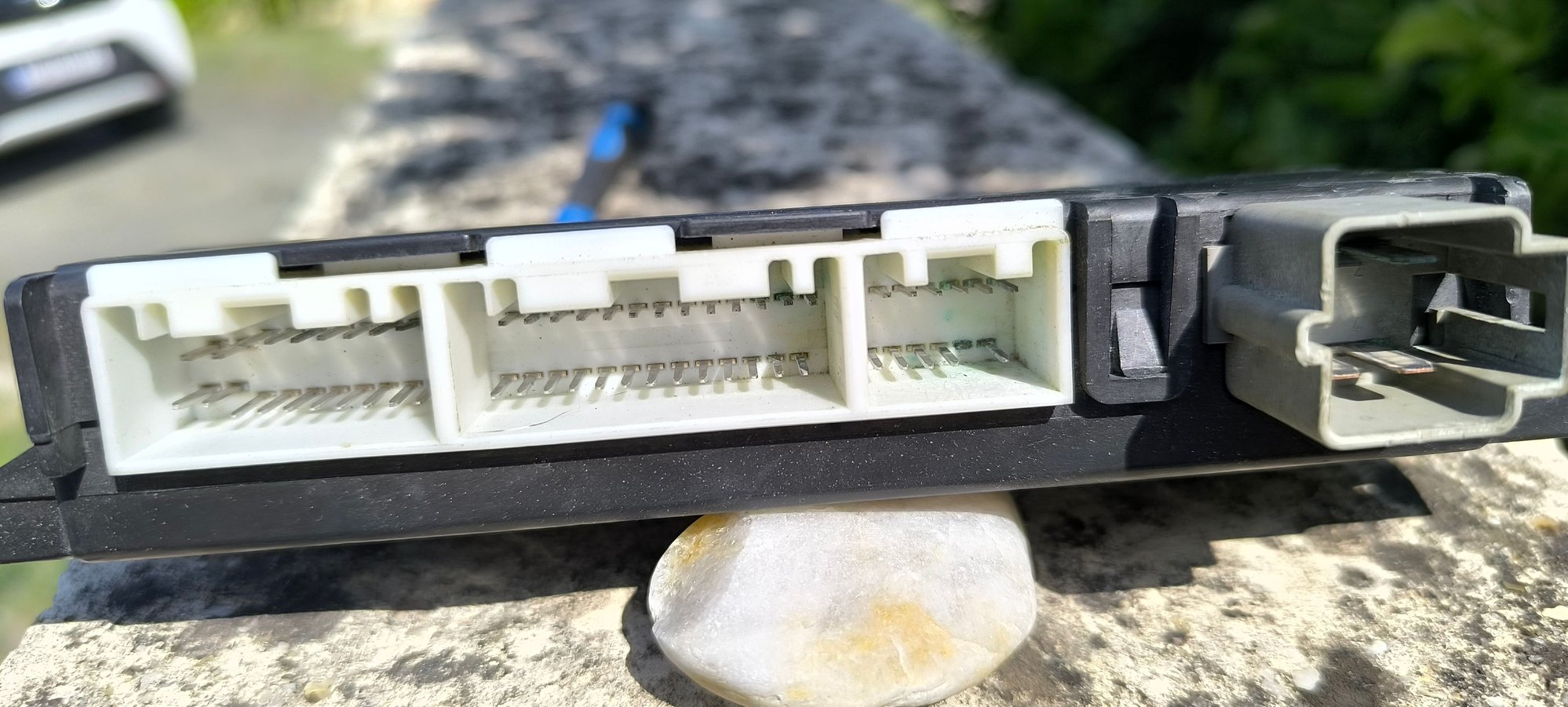

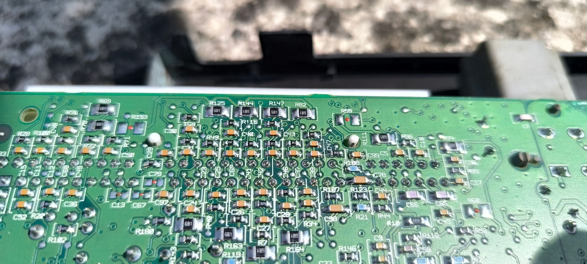

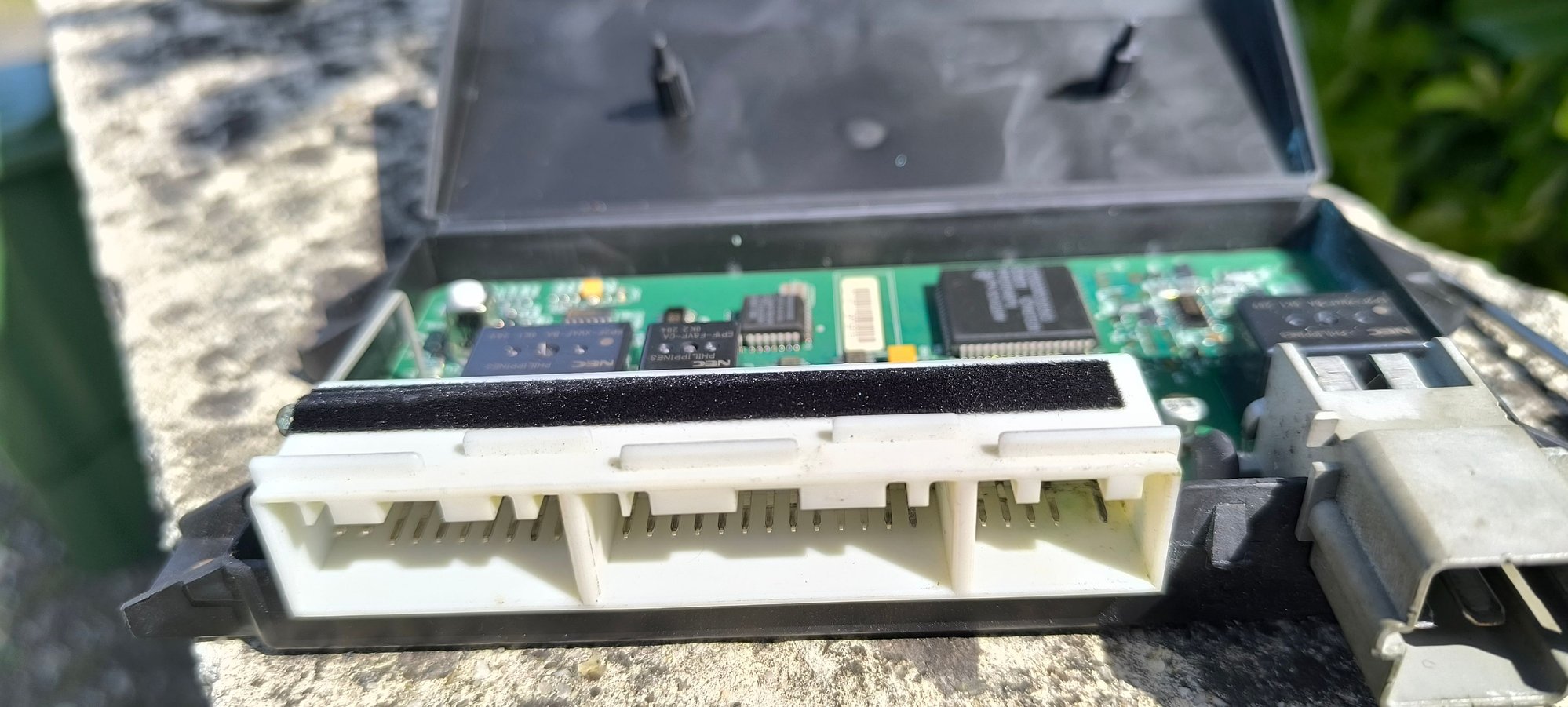

Have an '05 S type R which I love drivig but also lived with key fob that would't respond after car sits locked fo 20 minutes or so. Could open with key but alarm would sound, so had to disconnect horn.
Online suggestions included replacing the DDM. Purchaed one at minimal cost specifically for my year/model. Alas, did not cure my problems and local dealer said DDM had to be a new virgin to be properly programmed specifically for my car....but no longer have software at dealer to support an '05! Removed the door panel andn DDM. Noticed that two of the male leads from the module were badly corroded...in fact one was broken off. With some patience and careful solderig, was able to solder a couple of lead wires to the backside of the multi-in terinals and splice into the door's wiring loom.
Eureka!! Everything now works perfectly including all the special fob functions. Still have a woking (?) '05 DDM from a S type R if anyone wants it CHEAP.
Bob in KC.
