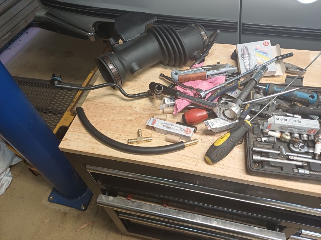

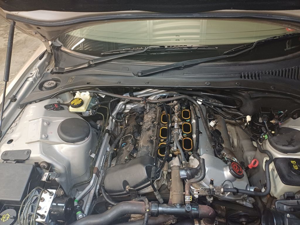

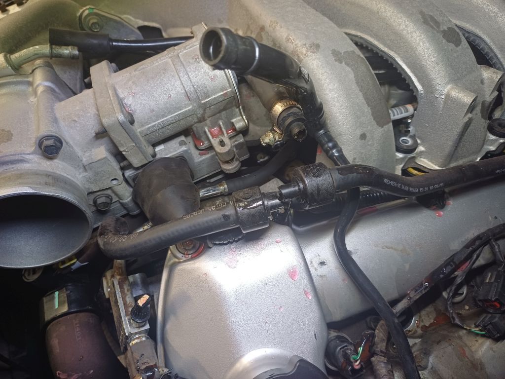

So I figured I better whip the plugs and coils out of the Jag last night, so its ready to swap in the new coils when they arrive.
Obviously I said "golly gosh, that isn't good" ..... or, um ... words to that affect ..... FFS.... I barely applied any force to that connector and it broke like it was made of nothing
I guess I go and try to find a brass fitting or similar that will join that mess back up. Its not a simple 5 minute job to get to the plugs under that manifold. I wonder if they have ever been changed ....

With a 20+ year old car you need to expect that ALL the plastic and rubber stuff is beyond it's lifespan at this point. So any repairs will result in broken plastic bits. Much better to plan your work and replace all of that in one go. Otherwise you will continually need to go back in and replace those parts one by one.
Have you replaced all the coolant hoses?
Actually all the hoses, rubber and plastics (other than the supension bush covers) are in very sounds, good condition. I think its because the car is quite low milage, so it hasn't seen the heat of 25years of baking in the engine bay

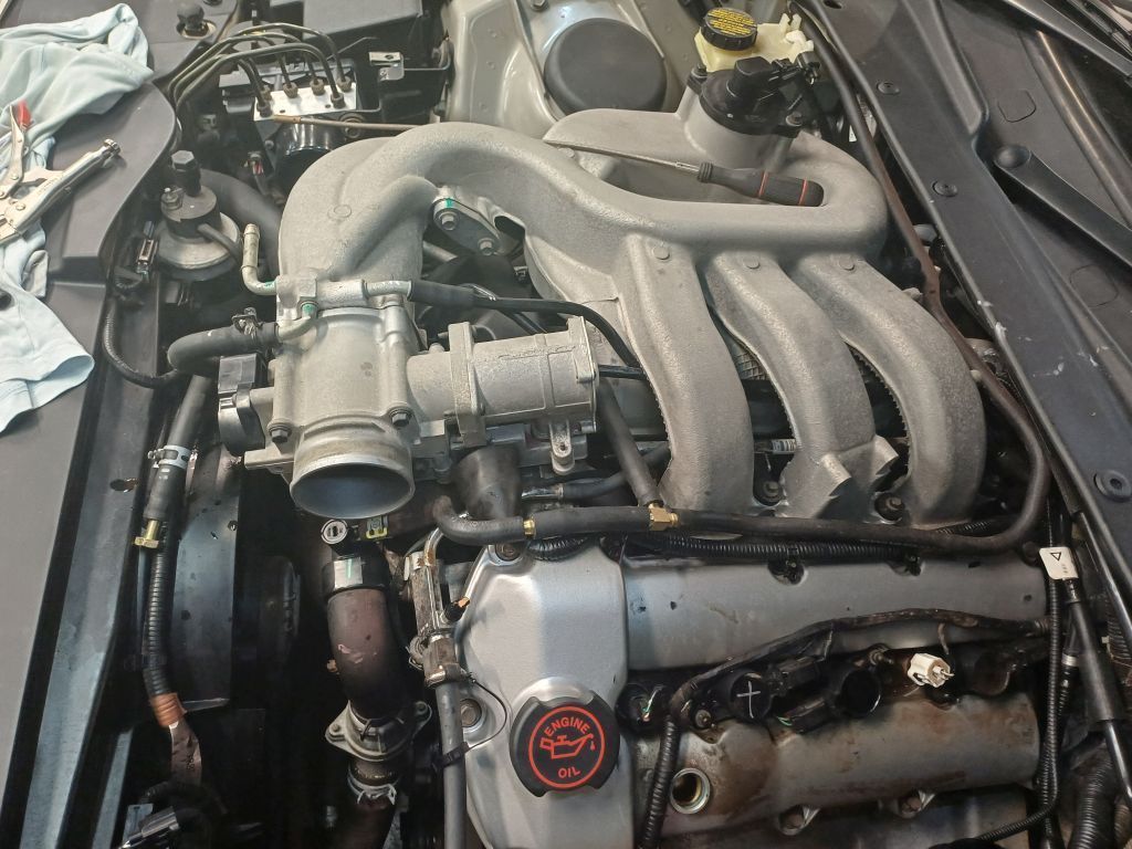

Well the coils I tried to buy on ebay .... a week later they tell me they actually aren't in stock ... sigh ... so now I have another single coil on order through a different ebay shop. Hopefully later this week.
Look at that, did they only make the visible rocker cover out of metal?
I didn't even bother to price a new coolant line. I just can't stand plastic crap. So for some pocket change I just grabbed so fittings.
A fix that is a million times better than expensive crappy plastic molded junk Yes i'm aware I haven't put hose clamps on there yet in this picture ...

So YAY ... I get to pull the top off the inlet again .... try too see what the problem is again ..... Did I sit the inlet manifold on this electrical connector messing it up somehow when I changed the coil (it looks perfectly fine)
Oh, that brass fitting I've used after chopping out the molded plastic crap. Its bloody magic. You just unscrew the coolant lines here where its readily accessible and you can easily lift the top half of the inlet manifold away
