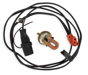

Might want to check to see if the car has a factory installed block heater. Mine does.
What's the block heater, does it heat the engine before you start it?
Yes, exactly. The typical example consist of an electrical immersion heater that warms the coolant prior to engine start. It's normal here to see cords dangling out from under the hood or through the front grills of cars and to 'plug a car in' to the mains for a few hours in really cold (-30*C or lower) weather. Warmer than that I don't bother.
Looks like this:
I bought a new-to-me SUV last month as a winter beater. I should go see if it's got one.
