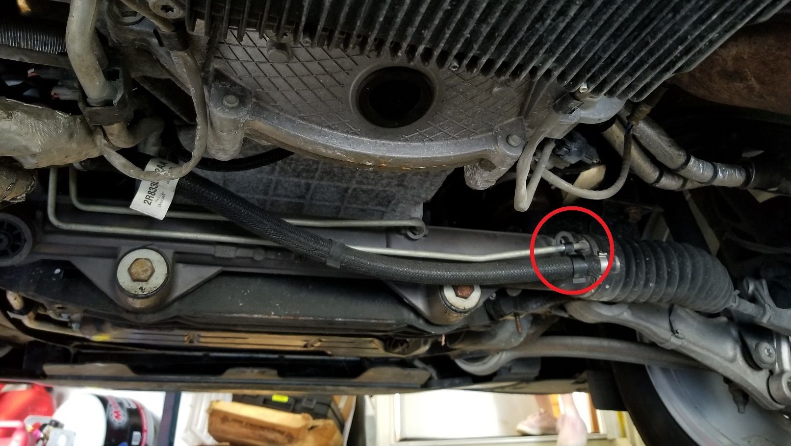

RF69,
1. The steering rack is in line with the rear of the front tires. On the S-Type you'll need to drop the plastic undercover to get to this. (I assume an XJ is the same)
2. In the top picture I posted you can see the two metal pipes that go to the steering rack. The one on the right (US passenger side) comes from the bottom of the PS fluid reservoir.
3. Put a catch pan underneath & loosen the PS fluid cap
4. Loosen fitting w/a 12mm wrench. When its fully loose pull straight out on the pipe and fluid will start to drain kinda slow.
5. Drain until is starts dripping slowly
6. Reinstall pipe and snug fittng (don't over tighten as the hex can round somewhat easily)
7. Refilling the reservoir will take right at 1/2 a quart.
As for fluid type your owners manual should say what spec the fluid must meet. (the S-Type can use dexron III)

RF69, the top picture shows it clearly. You can see exactly where the rack is. You can see the right front tire, the transmission pan, transmission bell housing, ect.... crawl under there and remove the plastic panel that covers the bottom of the engine and you'll see it.
I bought this fluid at wal-mart.

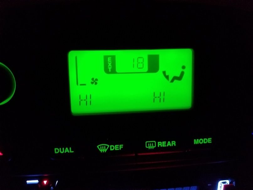

Thought I'd give a cold weather update.
Last night our family car read 16F and the Jag showed 18F. The roads are clear (no salt) so I thought I'd get her out of storage and put a few gallons of fresh fuel in as well as put a few miles on it to keep everything working properly.
The power steering had no abnormal feel and no squeaks. Efforts weren't any different and didn't change much when cold vs after being driven 10 miles. It feels 100% smooth and works perfectly.
