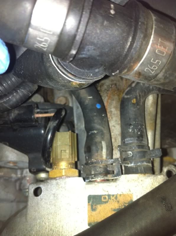

Thanks to the weather (Thats what Im blaming it on) I have a coolant leak now.
Its been in the low teens in North Texas and today on a sunny day I took the car out for a spin and I could smell coolant.
At first I thought it was line going into the intercoolers, dead wrong, Its a rubber hose to the right of the ECT sensor the rubber line has a pinhole and the whole line is swollen, not sure if thats the dreaded under the blower hose, but as soon as the car cools down enough for me start taking stuff apart I will know more.
May be able to cut and replce just that section of hose but we shall see.
Wish me luck.

Ok looks like it's the hose going or coming from the throttle body
I'm going to napa inthe morning to get a union and 3" of hose and that should fix it.
On second thought I think both of the lines go to the TB as the prewarming circuit for emissions,
I wonder if I should just eliminate that circuit all together.
Im not required to have emissions testing and I dont think it will make that big of a difference. emissions wise.
looks like yes, I can eliminate the throttle body warming circuit, which I will be doing tommorow, eliminating the under the blower hose rupture. since the lower hose will not be doing anything.
Im going to blow all the coolant from the line once the in/out from the coolant looped. So that there is no danger of the stagnant coolant causing damage to the throttle body.

It took some work, but the circuit has been eliminated this am, took it out for a spin and all seems normal, I guess time will tell when it gets cold again here in texas the negative impacts, in the mean time monday I will order a new hose, just as a precaution
