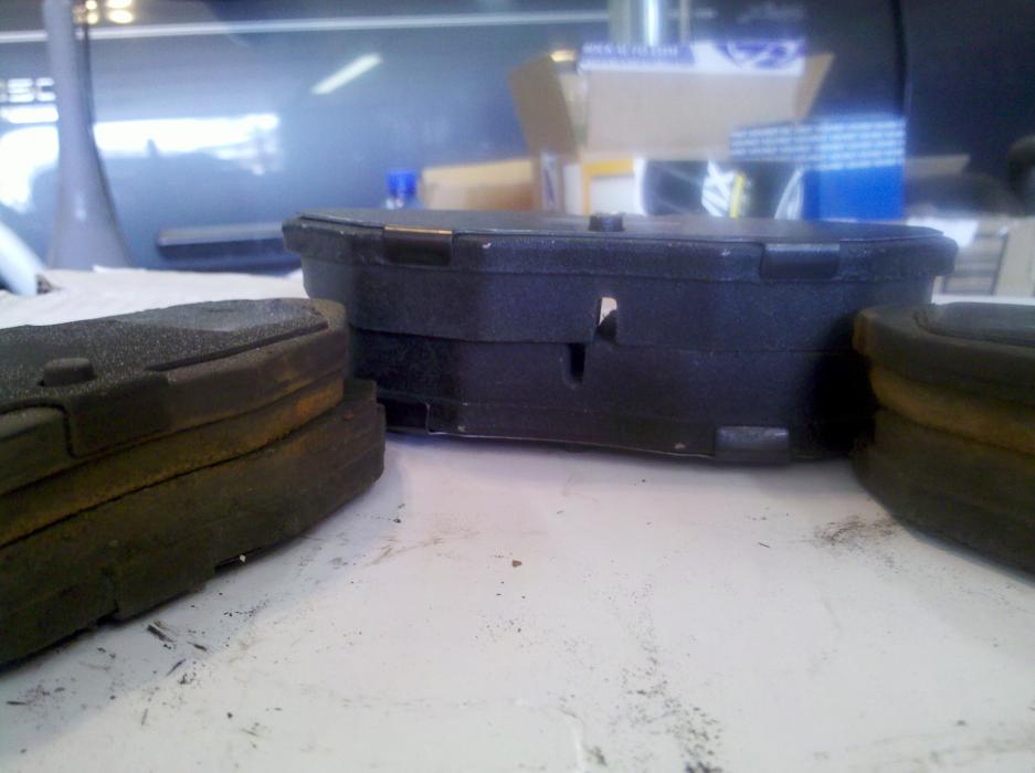

Default 50,160 mi.
Installed new pads and rotors on the rear of the '05 today. Here's a shot of the take-offs alongside the new. Naturally....the way I photographed it.....pads on the left are from the right side, those on the right came from the left.
50,160 miles on them....unless they were changed in the first 25K or so, not likely as the fronts hadn't been....
Funny thing is, you probably still had about 1/4 pad left... That tells you how little work the rear brakes do relative to the fronts...

Yeah....meant to put in prev. post that I measured a min. of 3/16" and max of 1/4" remaining pad mat'l between all 4 pcs. Nonetheless.....the one owning and driving the car was (squealing) that her brakes were squealing....did the fronts over a year ago, had pads and rotors on-hand from then, so I changed 'em...stops are straight and true with no noise (wasn't much noise before-hand, if I'd be honest, save that coming from the cockpit :-))

I think our car's rear factory pads may indeed do 60,000 miles. About 55,500 miles on the car today. So we'll see. Some owners have reported the need to change their rear factory pads prior to their front factory pads, which really surprises me knowing how soft and incredibly messy the front factory pads are....
When I hear that I think dragging rear parking brake...
Just like the STR's with their separate parking brake pads / calipers. In theory if the EBP is only enabled in park, how do those pads EVER wear out?
