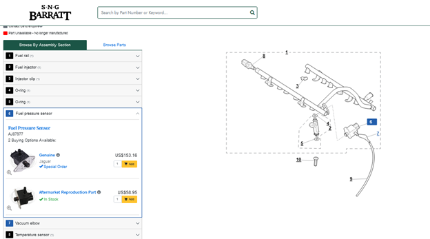

Ok so here is what the latest shop said they replaced, which seemed to fix my intermittent starting problem. I want to find out where this item is located, because I previously had replaced my fuel pressure sensor (on the fuel rail) and it didn't fix my starting problem. Several times in and out of this shop and a few thousand $$$ later they replaced this part and now my car starts up regularly.
AJ8 7977 Fuel Pressure Regulator 1 @ $205.61
Where is it locatd on the car?
https://www.jaguarparts.com/oem-part...ulator-aj87977

The fuel pressure sensor is located on the fuel rail. Here is an illustration from SNG Barratt's website:
Old Nov 12, 2024 | 04:31 PM
mikesbaron's Avatar
Joined: Aug 2022
Posts: 77
Likes: 7
From: Utah
Ok yes that's one of the first ones I replaced when my car began having issues. Are there two of them on the car or one? Because the shop said it was a "secondary fuel regulator" that they replaced. To me that sounds as if there is another one. Or is the primary one part of the fuel pump or fuel line system?
Old Nov 12, 2024 | 05:23 PM
NBCat's Avatar
Posts: 6,068
Likes: 2,983
That is the only one I've ever seen.
