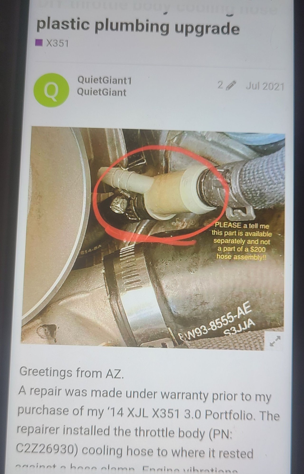

Old Feb 25, 2025 | 11:16 AM
  #28
Lanezz's Avatar
Joined: Dec 2021
Posts: 15
From: Brandywine, Maryland
Default Mystery part to throttle body cooling hose
Hello. Do you know whether or not this piece that is protruding outward is supposed to be connected to something? I have a 2016 Jaguar XJL.
Old Feb 25, 2025 | 01:24 PM
  #29
bydand's Avatar
Joined: Aug 2012
Posts: 413
Likes: 177
From: Vaduz
No, its is blanked, and the upgraded hose/fitting.
You are in the wrong model forum. S type. You should have posted in the XJ x351 forum section.
and greetings.
