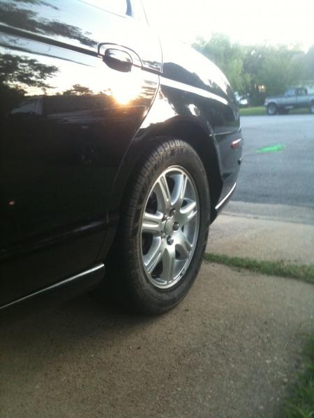

Well, I got'em mounted last night. Cooper Lifeliner SLE Sport 245/50r16. They look great, almost new. They fit very well, better then OEM imo. (looks anyways)
They only changed the speedo 1mph. Before if I set cruise @70 mph on the car, the GPS said I was going 68mph, now it reads 67mph. I can live with that. These are nice tires imo.
Thx for all the input Gents. Now we all know that 245 50 16's fit nice on the 3.0 w/ OEM wheels.
Edit: Opps, I ment 245/50r16's.
