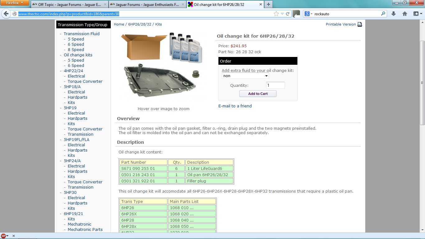

It seems you can buy the filter separate from the pan but only for the metal pans, the Jag uses a plastic pan and the filter is integral.
If the OP needs a new pan I guess he could buy a used metal pan, the difference between a filter change kit for the metal pan and a kit including a new plastic pan is $40 so the used pan would need to be cheap IMHO.
They do but it's not the correct filter.

I would really recommend getting the kit from CTSC. Klaus is an expert on pretty much all things ZF. The prices are the best you will find.

This looks like a good kit, it includes sump/filter, 21 sump screws and 6 ltrs of oil PLUS the GENUINE sleeve:
ZF6HP26 Filter change kit inc oil. ZF6HP26 plastic sump
