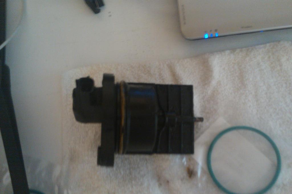

I cannot find the lower one. is it directly below the one I have removed, or on the other end. have it apart now.

ok so I freaked a little early, it was the lower I removed first, the upper is right there under the little plastic shield.

OK so I completed the o-ring job, my cross bar had 7 bolts on it, three broke during removal, so they had to be drilled out, replaced them with 5/16 grade 8 bolts, washers, lock washers and nuts. Also I found it was easier with my meat hooks to remove the filter and complete housing. Took the car for a test drive about 20 miles no shudder yet, we will see. Thank you to everyone who posted on this thread.
