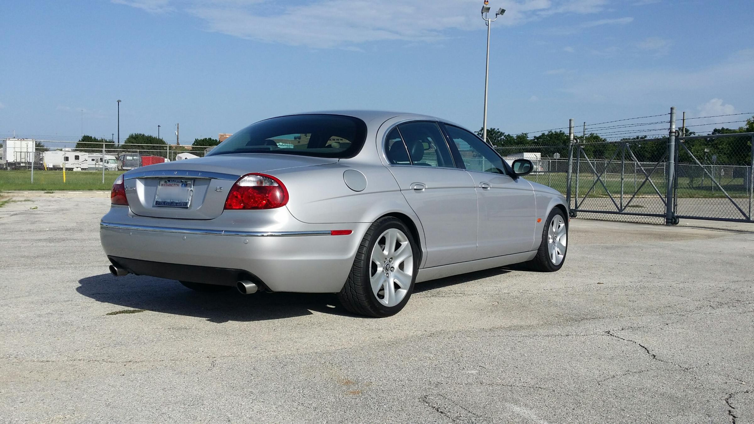

This weekend I upgraded my suspension on my 2005 S-type base model 4.2.
Bilstein B4 Sport Shocks OE replacements, H&R Sport Springs, 18" rims off of a 2010 XF, Bridgestone Tires size 245/40 R18 .
So far it drives like a charm. No rubbing and not too hard. Stable around corners.

Looks nice, i bet the suspension feels alot better, nothing like some new shocks.

Yes my rear shocks were blown and my 17" tires needed replacements. I figure I might as well upgrade the performance and change the look a little bit.

Wow... Looks KILLER man, really well done! That is one sweet looking V8 S-type!!!
