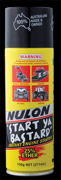

Only surmising but Damp Start will fire with virtually no compression - maybe big end fling did the rest ?
I love the Ozzy version.

LOL! "Start Ya *******" LOL! Agree, likely swung the crank fast enough while increasing compression.

Hilarious - sign me up for a few cans...

stevein... - I didn't know it would do that.
Love that pic!
