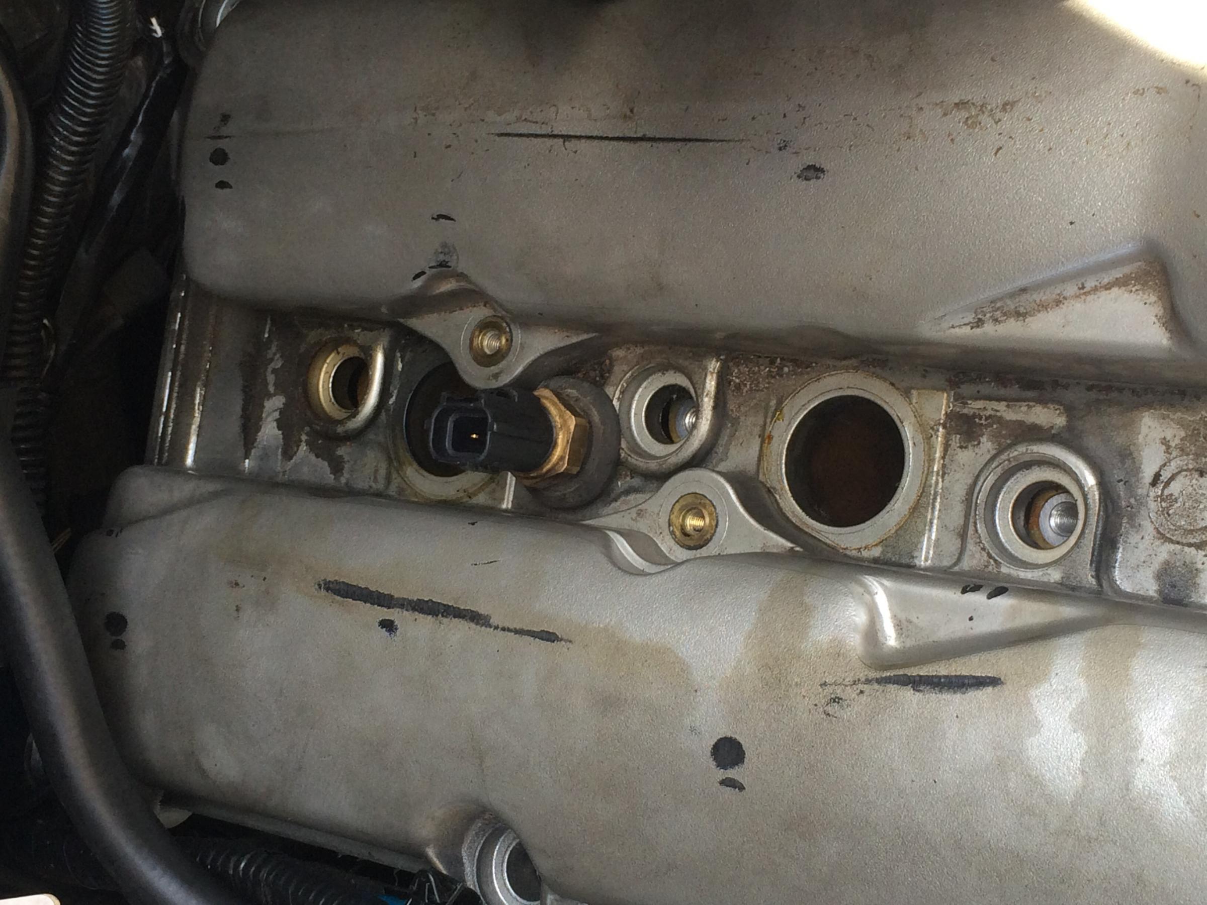

I'm installing new valve cover gaskets and I got the passenger side done just fine. I'm having trouble taking off the cover on the driver side. Can anyone help me. This bolt with the electronic coming out of it I think is what's holding me up.

That's either a sensor or switch and highly unlikely that it is clamping two parts together. You may find an increase in response rate if you identify whether you are working on the V6 or the V8? Do it once in your signature and be done with it. Also, by location=Washington, the reader assumes when you say "passenger side" you mean right and driver's side = Left, but it may be more clear to state what's what as the car was offered in both LHD and RHD versions.

All the bolts are off. I did the passenger side and you have to take the intake manifold off I thought that side is more difficult so I tackled that one first now I'm have trouble with the driver side

If all the securing bolts, are off it could be the stiction of the seal cover joint stuck to the cover/ cylinder head. It being baked or stuck on with sealant?? Try giving the cover a small, light tap (shear force) with something soft. The wooden end of a hammer handle to break the cover joint free.

Agreed - just trace around the perimeter flange of the thing and if you've removed all the fixing bolts, it's just stuck on with surface tension - maybe someone's been there before and stuck it down with rtv.

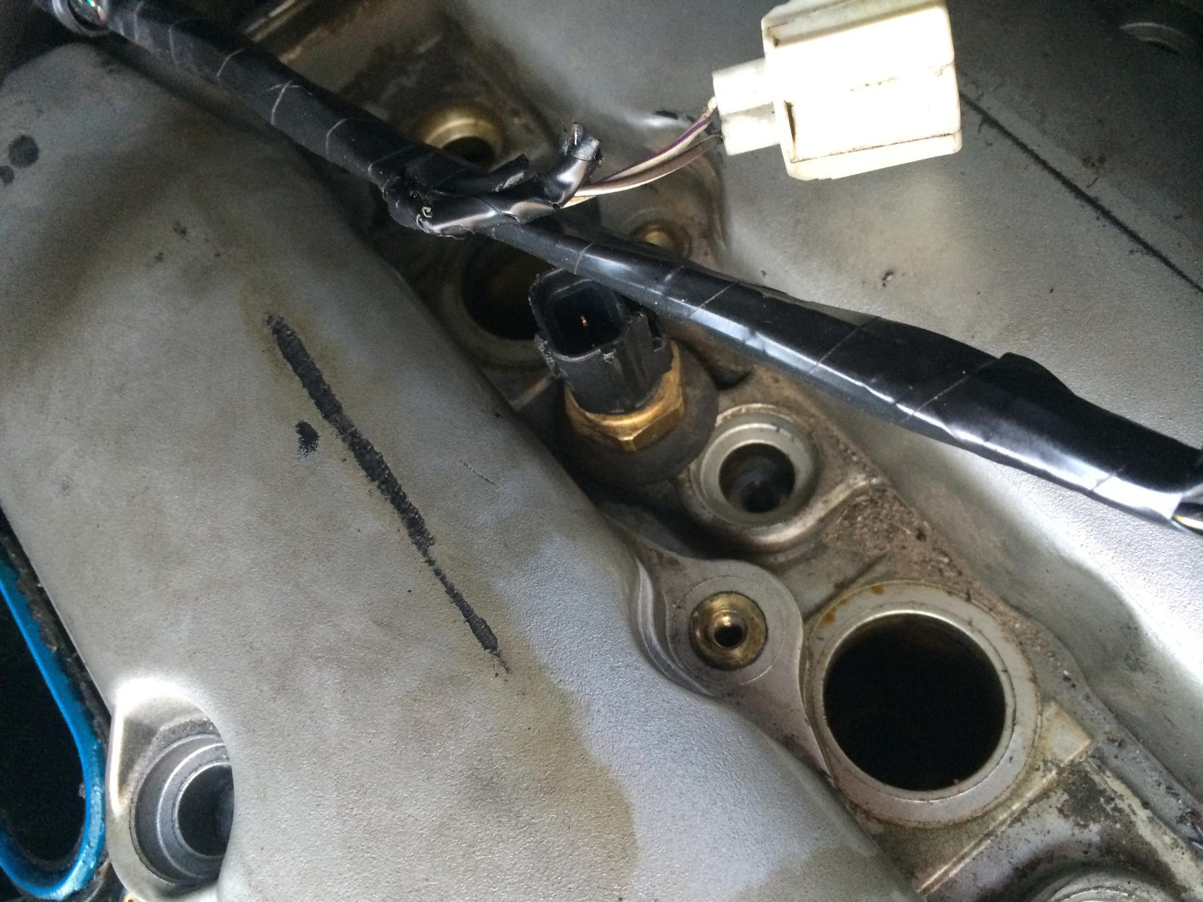

I can't get this bolt off that has the electronic connected to it it's the only thing holding down the valve cover

That does not hold the cam cover down. That is an engine sensor that's threaded directly into the Aluminum. You are focusing on the wrong thing.
Your cam cover is most likely stuck as the guys above have told you. You need to pry up on the edge of the cam cover. It's possible the last repair was done using silicone and the cover might be glued down pretty tight.

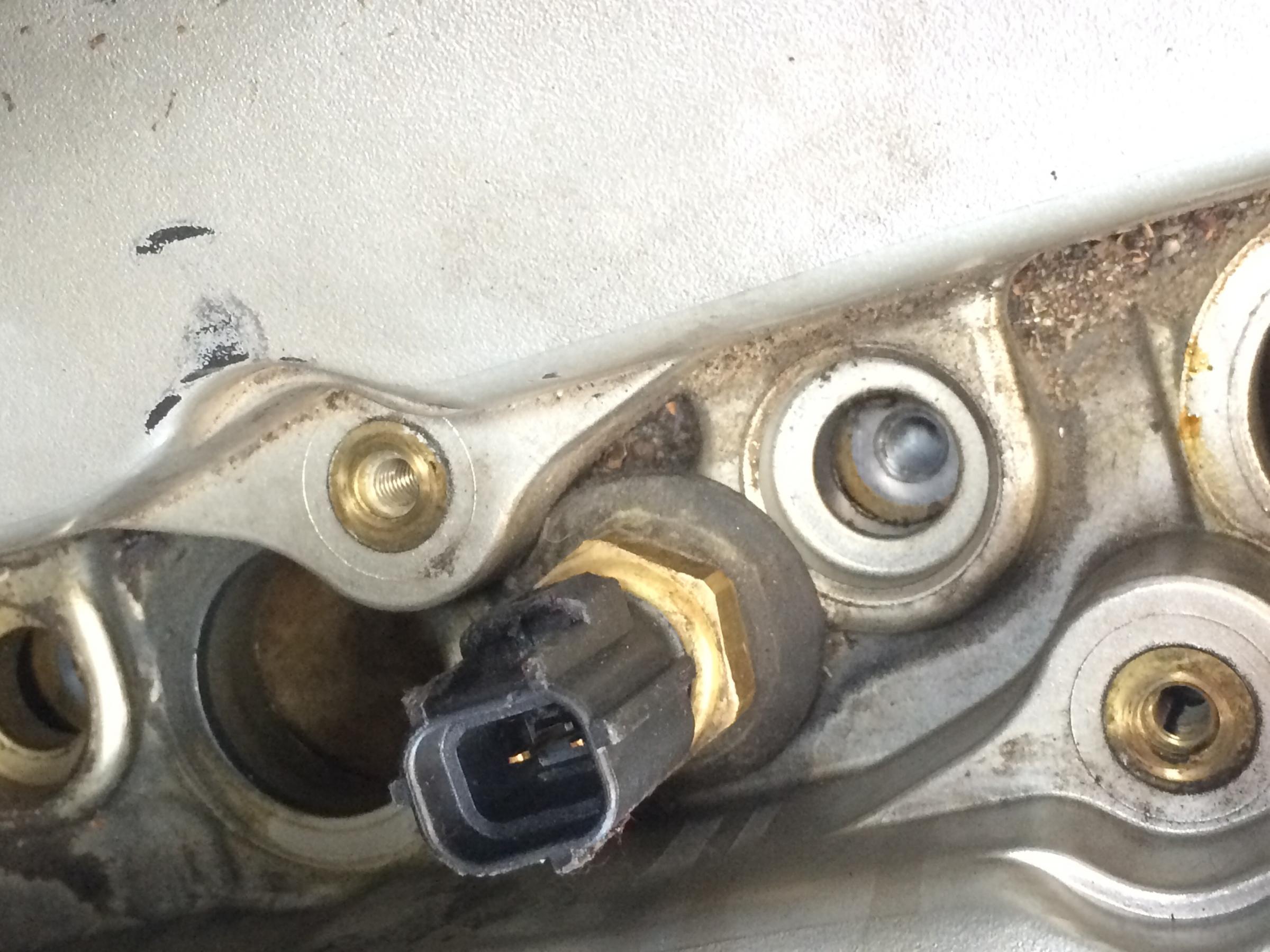

The cover is completely loose but that's holding it done it's got a rubber gasket blocking the cover from lifting up

Can you take the sensor out?
Should just unscrew.

i had to use a deep socket to get that one last part off it was holding down the valve cover just like i thought
