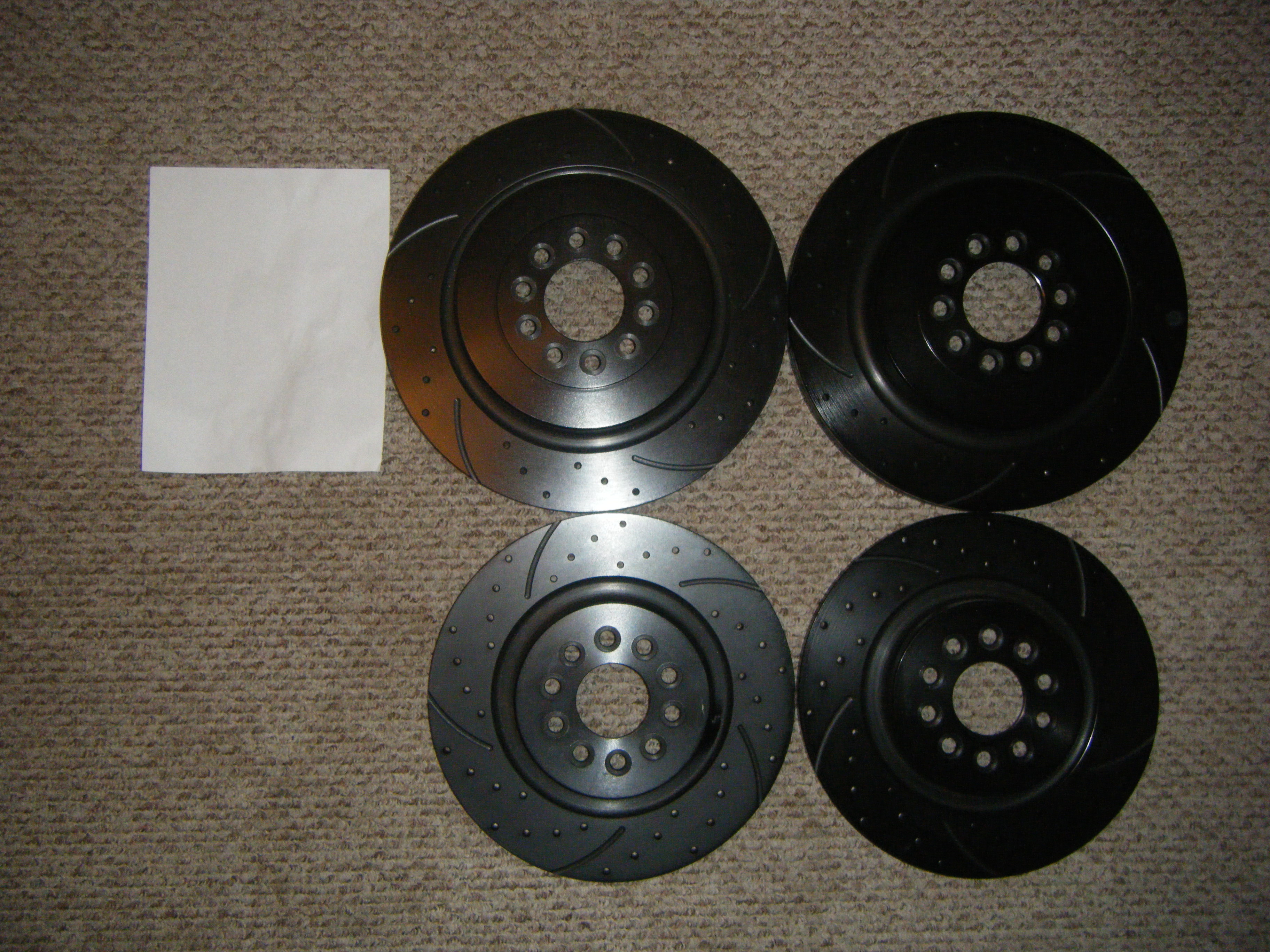

Well even if my rotors are fine I'm still installing these bad boys that the brown truck just brought me today. Hopefully I'll only have 1 bent hub if any as I'm seeing they arent cheap.
Thats a standard 8.5x11 sheet of paper couldnt find my ruler.
