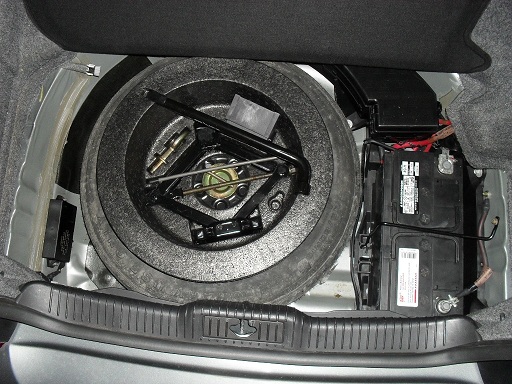

Here is a picture of my trunk/boot. 2003 S type 3.0 Where would I find the build sticker? Thanks

What data do you want? Most is on stickers by door hinges etc. Some sort of encoded data is in the boot (trunk) but can be hard to find, doesn't seem in a standard location.

Sometimes my curiosity gets the better of me.
My steering column was making a clicking sound at one end of movement.
I thought that it might need recalibration, like the windows.
So I go to recalibration in IDS, and I select steering recalibration.
Well, I got into the procedure, and decided to back out, but I could not.
You know that's what got me scr@#wed with the ECM program as well.
Anyway, it stated that I needed the code off of the build sticker and from the steering column.
I really wanted to back out at this point, but could not.
So I pressed on hoping it would say, "hey, you didn't provide a code!" and just quit without doing anything.
Well, guess what, not providing a code is the same as providing a code.
I got a message that the steering unit had been programmed and viola, I can't adjust the steering up or down, or in or out.
So, I am thinking to get the information off the build sticker and the steering column to fix this mess I got myself into again.
But, I can't find the build sticker.
I have looked further up under the carpet (top part of picture) and I have tried to look behind the side wheel well covers, but will need to pull them out to be sure.
I found a sticker at the A pillar, but that was just the vin and trim and pain codes.
I can look some more, but would just like an idea of where to look.
I am very tempted to load the previous VID and attempt to write it back, but I am a little concerned about what else I might screw up.
Thanks

Well, I ripped the tire, the battery, and the battery tray out of the trunk, no VCATS label.
I opened the side panels and checked in there, no VCATS label.
I found this TSB 307-7 on the internet, and on page 3, the VCATS label is in plain sight next to the spare tire.
