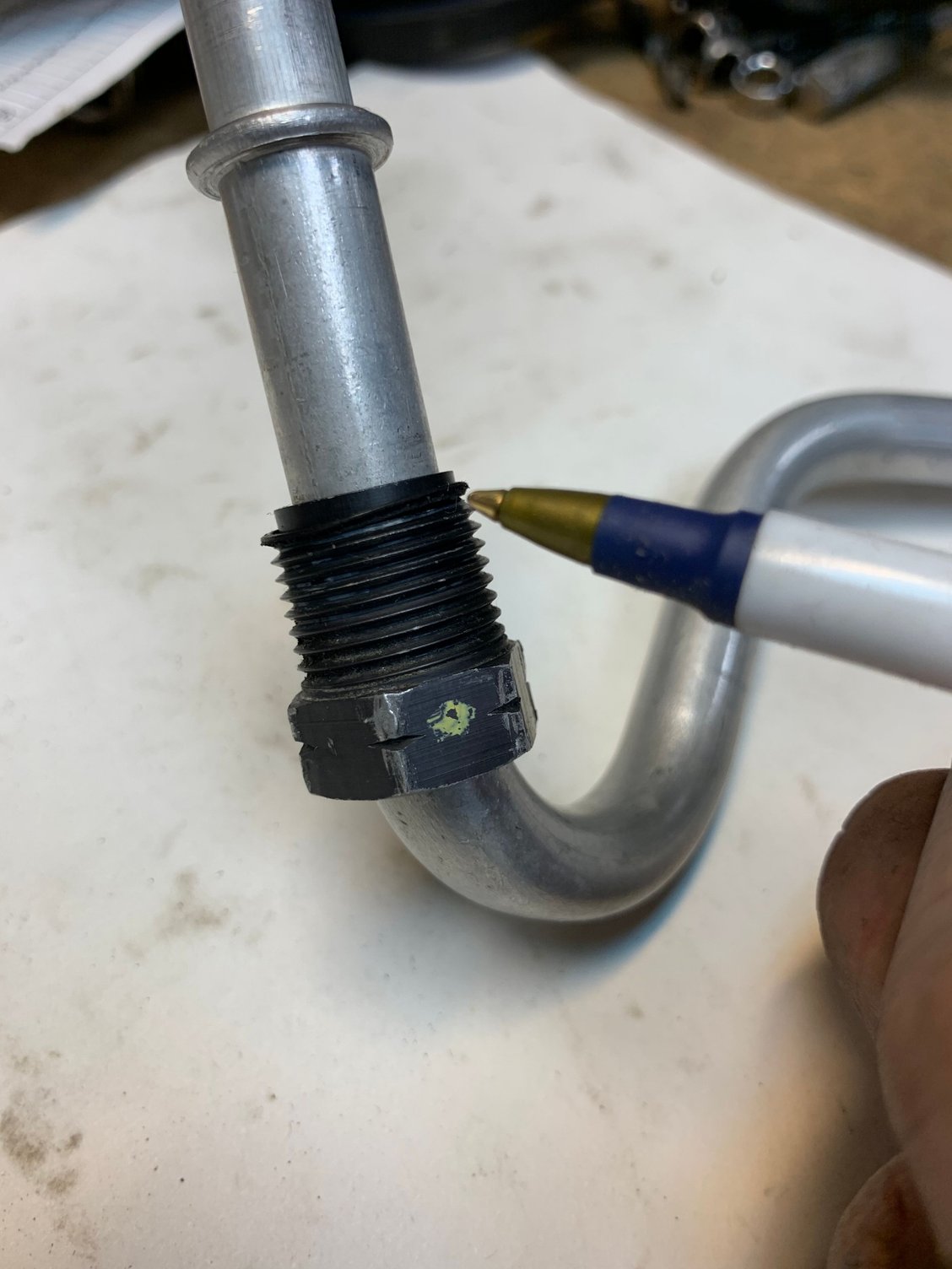

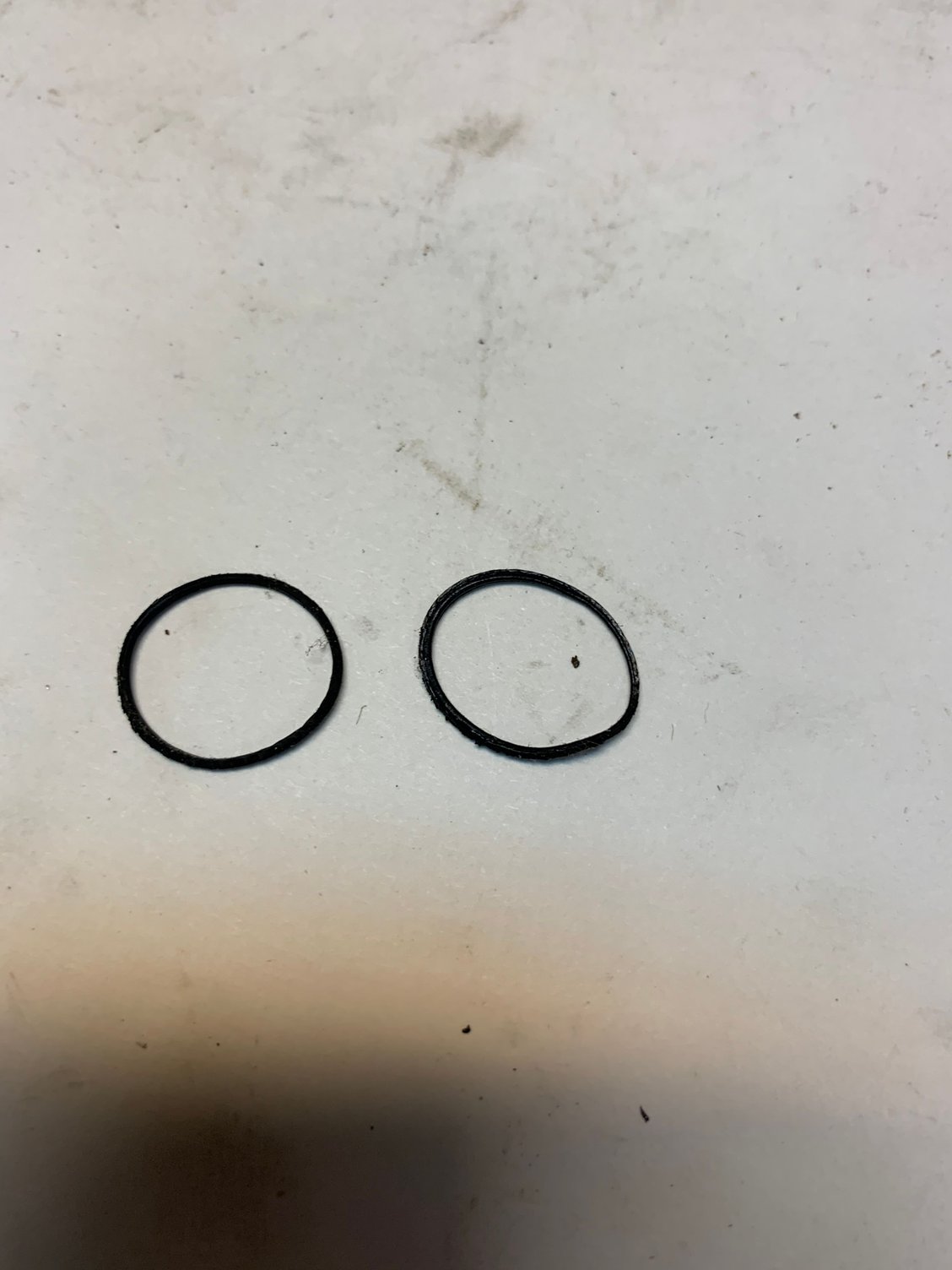

Ok debating whether to delete this post due to the ERRONEOUS AND IDIOTIC information I presented.
so it turns out these skinny o-rings I showed ARE NOT THE CORRECT ones.
these skinny ones are simply the SHEARED OFF EDGE of a previously installed o-ring.
I went and looked at my parts jag and it didnt have the skinny ones on the nut but fatter ones on the tube lime youd expect. But they were skinnier than the ones in my o-ring kit so they are a special size.
bottom line is the oring goes here:
Only use the right size oring here! None on the nut

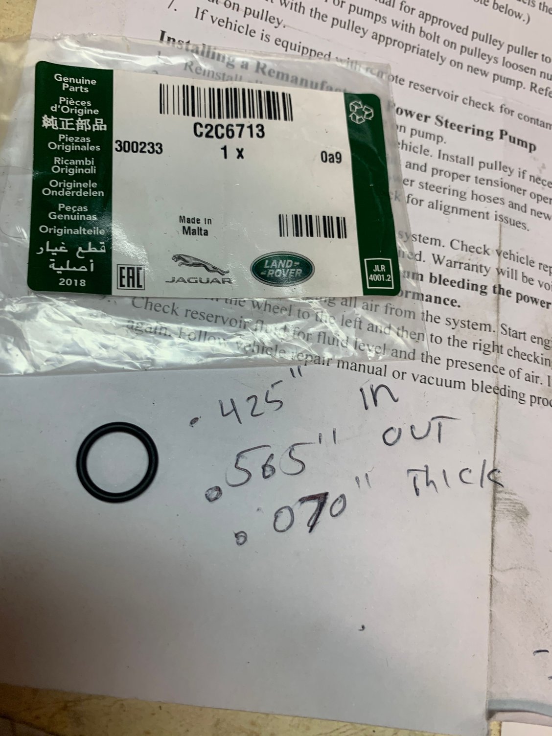

Heres the correct oring!
id is .425”
od is .565”
.070” thick

For future reference, this would be an EAI #013 (7/16" x 9/16" x 1/16") NBR (Nitrile) O-ring.
They can be sourced at many places inexpensively.
