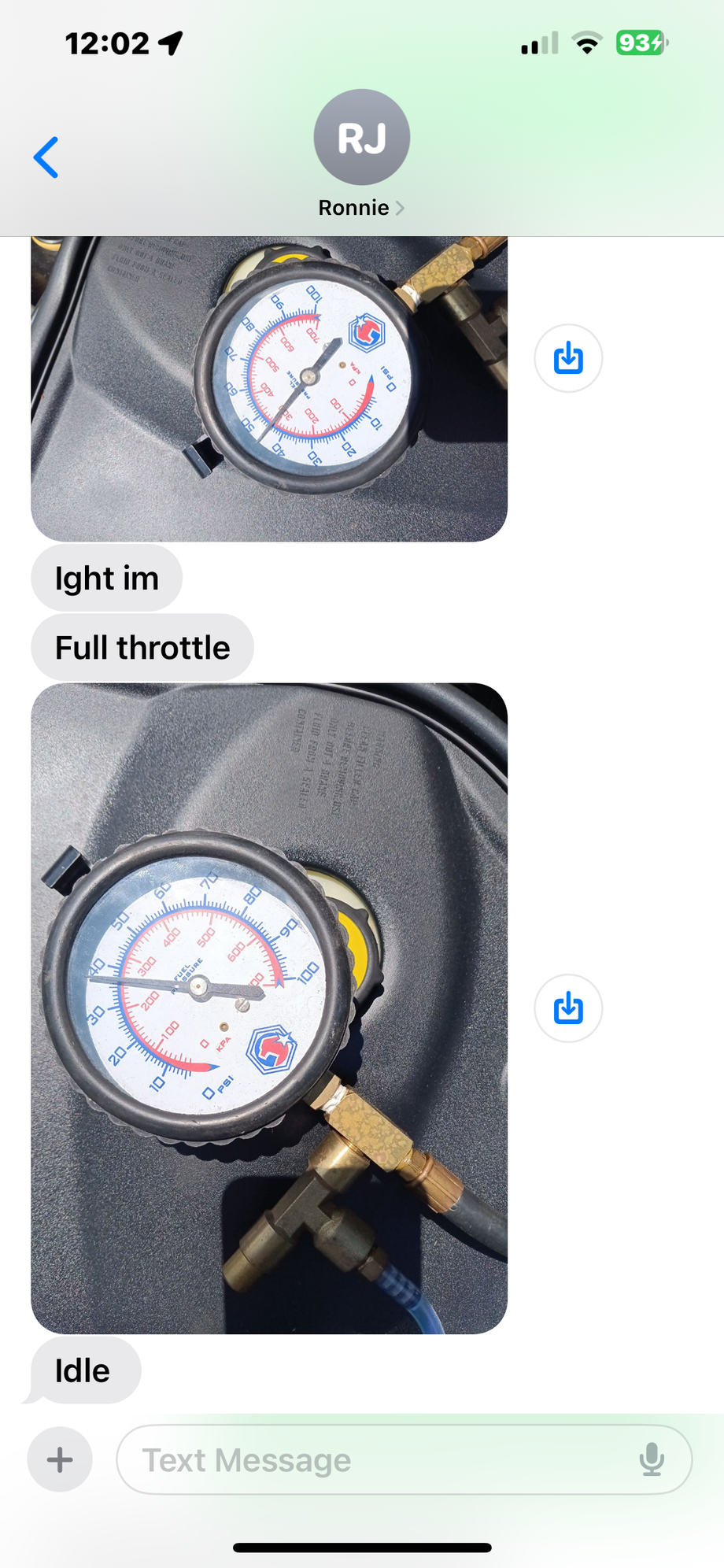

I have a 2000 vondon plus 4.0 with 62000 mils. That i inherited so I am new to the jaguar. The car set in my mother-in-law‘s garage for over a year not being used the car cranked up fine I drove it home which was a 3 Hour Dr. when I got it home I changed the fuel filter. The fuel that came out was black. I purged the fuel system until clear fuel started coming out After refueling and added seafoam fuel cleaner, the car runs perfect and normal city driving but when hard acceleration occurs to check engine light come on with a code of P 1000 along with reduced performance and the car stumbles had the fuel pressure checked and confirmed OK When analyzer connected to car it was found to be running lean no other codes or problems noted any ideas ? Thank you

First P1000 only indicates that someone has cleared the codes which also resets the readiness monitors. Your will always have either P1000 or P1111. The P1111 code indicates that the readiness monitors have been set and the car is ready for inspection. So neither of those codes help with troubleshooting.
You most likely don't have a code reader that works very well on Jaguar's? What code reader are you using?
Again post what the fuel pressure is? Post what lean code your getting?
One thing that stands out is the car has been sitting for multiple years? Plus the car is now approaching 25 years old. It's common for fuel pumps to need replacing in these conditions. Good that you changed the filter.

Lots of codes are required to flag only if they occur in similar situations during 2 warm ups. A code clear restarts the 2 so don't be clearing any! (And you can't clear P1000 as it's a status not a code.)
i will find out what the lean code was not geting the p1111 only p1000 followed by restricted performance the fuel psi is as fo

If you get restricted performance there should be more codes in the car?
