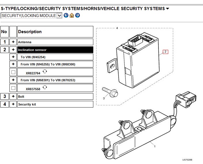

........ I'm I correct in thinking the inclination sensor is part of the jaguar alarm system in case the car is lifted or jacked up ?
And can I just take it out and connect it in the new car ?
Jurgen,
Those of us who use Cross Channel ferries from England to the Continent are well used to the Inclination Sensors activating car alarms when the North Sea gets rough!
There is a Part Number change on the Inclination Sensor (item 2) at VIN M45255.
Provided both cars are within the same VIN range, the Sensor will be compatible.
However, I think it could be more complicated than just fitting the Sensor from your old car to the new one. I would expect any additional or replacement Sensor will have to be programmed to the security system with the Jaguar Dealer diagnostics equipment.

Hi
I already have it plugged in haven't tested it yet but no complications so far.
vin of the donor car is L57821
vin of the new car is L69244.
The part numbers in the screen print are superseeding part numbers most of the time the part is the same only the number changed.
My Guess is it's just a switch type thing so little chance of something going wrong. will test it someday this weekend.
