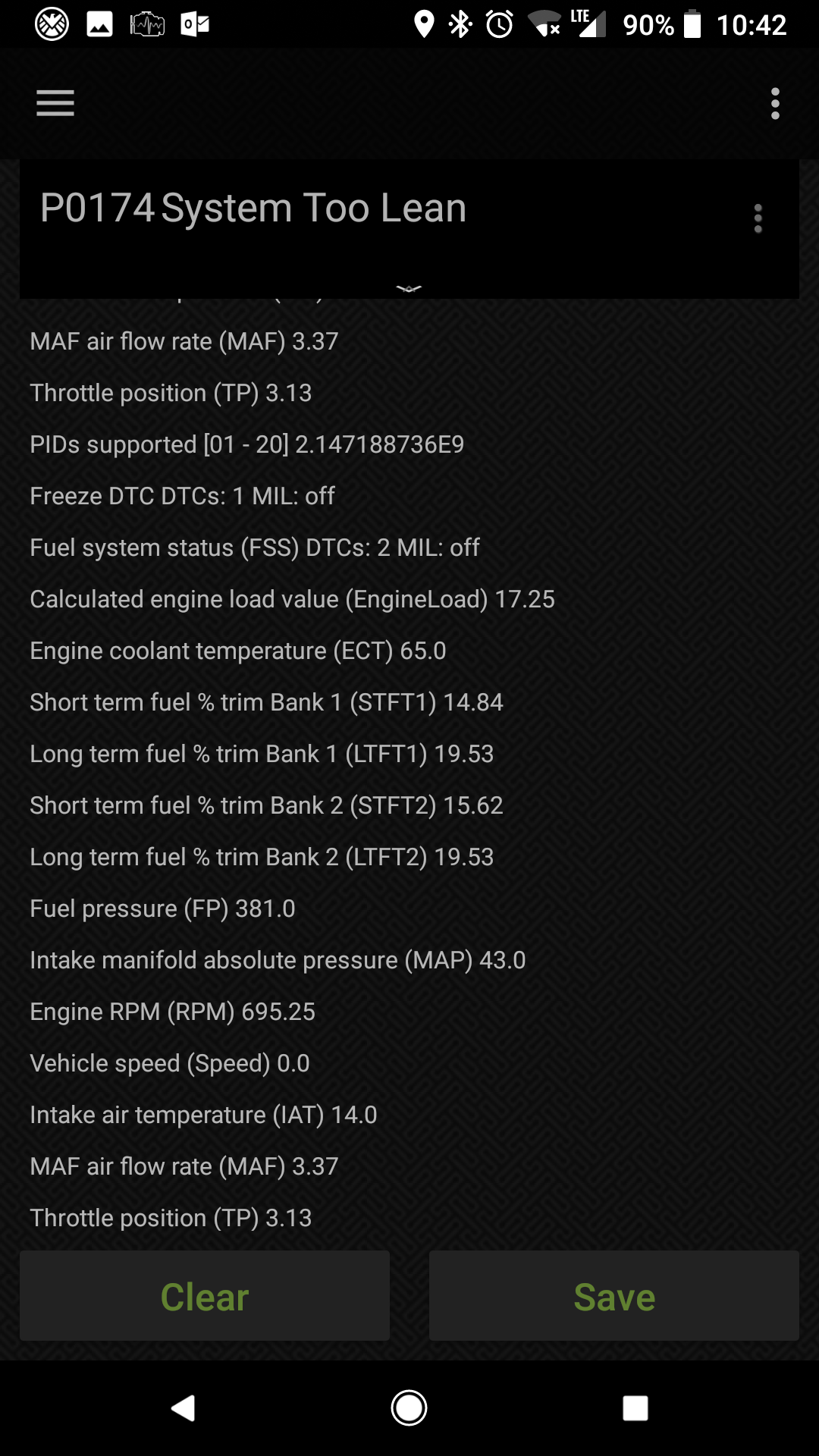

Thanks for the suggestions - I'm wondering about the accordian hose as it looks like the prior owner uses zipties to secure it... hmm...
Here's the code info after driving it around for about 20 minutes (I thought that was best - if you need cold readings let me know)
P0174 codes 1/2
P0174 codes 2/2

Uhhhhhhhh.......zip ties? I think that would be a logical place to start.

Even a tiny leak would need fixing. Zip ties suggest a major leak
