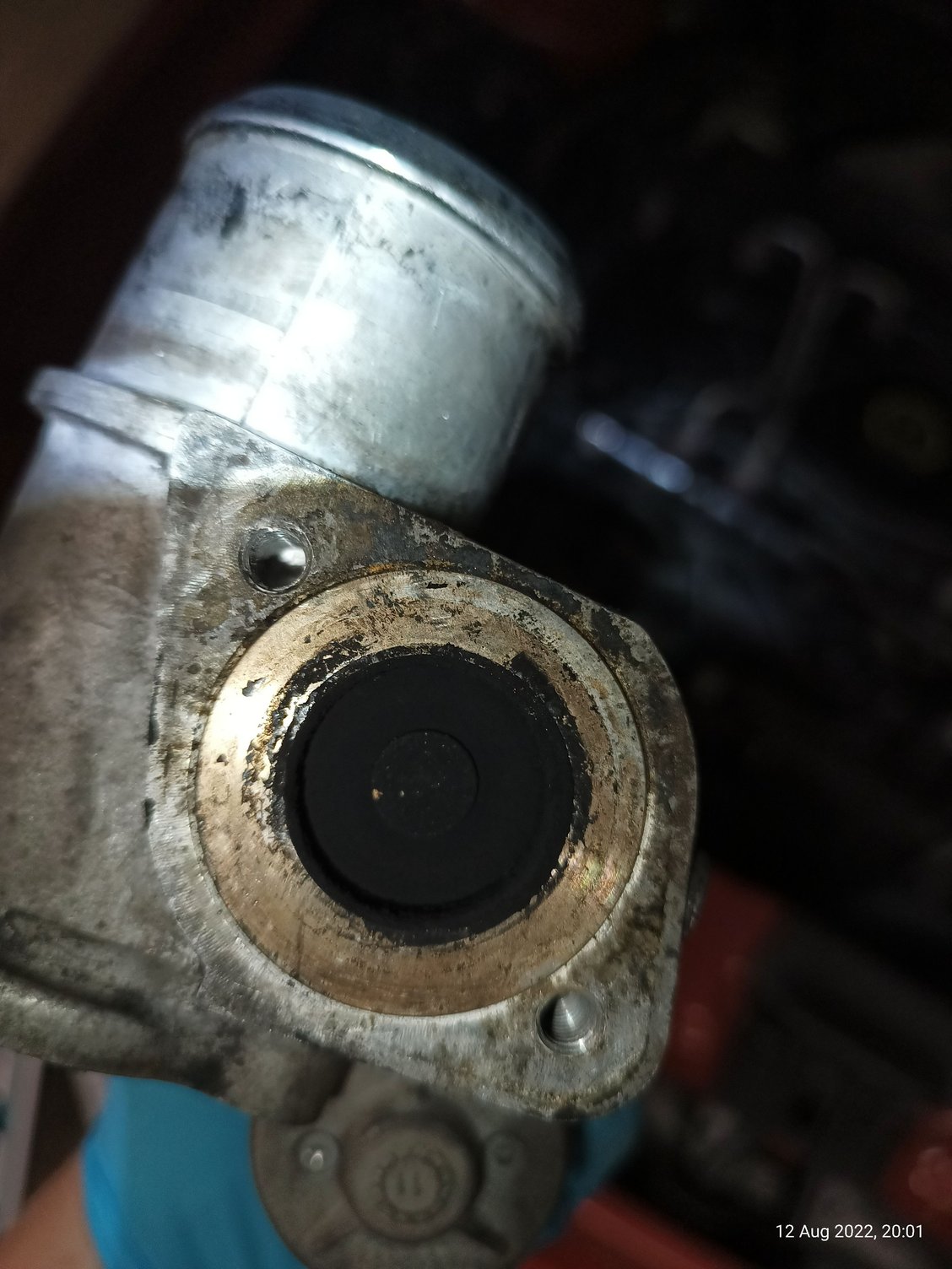

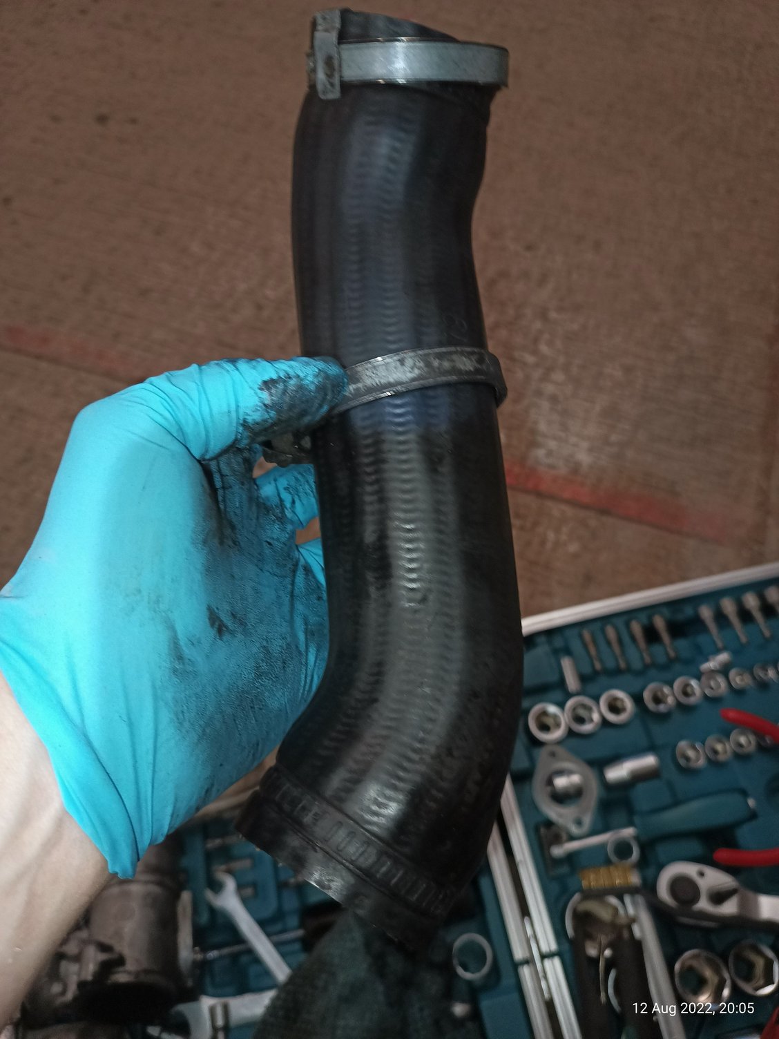

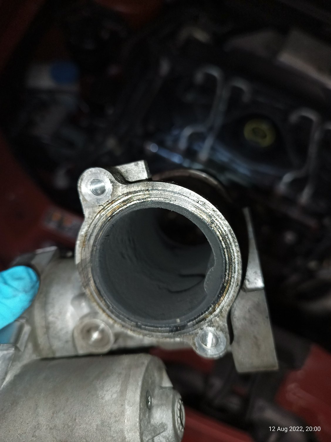

Removed intercooler pipe - no cracks as farvad I can see/feel (photos as proof I actually did this). EGR seems cleanish (I did clean it about a year ago). However, I don't remember smell of diesel when I was removing intercooler pipe a year ago - is that a hint something is terribly wrong?
While I wait for insights from the forum, tomorrow I will focus on the turbo. Need to figure out how to test the turbo actuator (it moves up on start up, and moves back down on shut down).

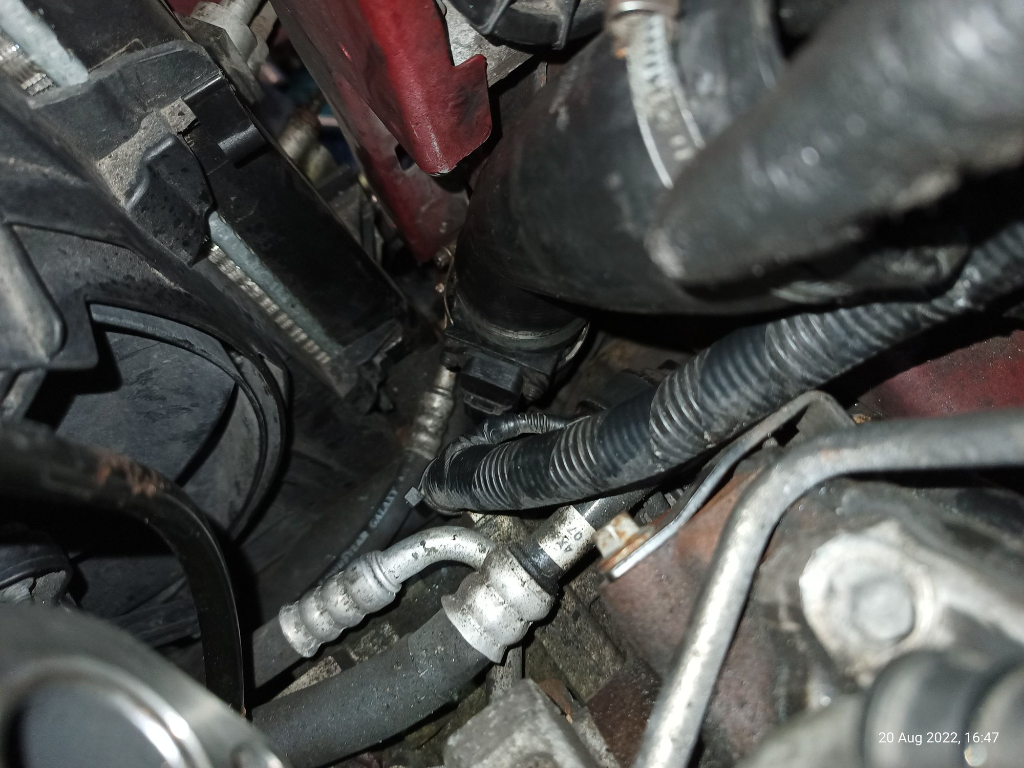

Working away slowly at this, had the turbo and the actuator looked at by a specialist, he said turbo is fine an no evidence of oil leak in the turbo. So I went back to inspect the lowe elbow hose from the intercooler, and it was an absolute pain to get there (had to remove the front bumper).
I couldn't figure out how to disconnect the MAP sensor - didn't want to force it, and it seemed no matter how much I tried to squeze the plastic "retaining lever" it wouldn't budge. I managed to remove the lower elbow eventually (annoyingly, it wasn't cracked and the hose clip was fine...).
Anyway, just wondering if there's a trick to disconnect/remove the MAP sensor?
