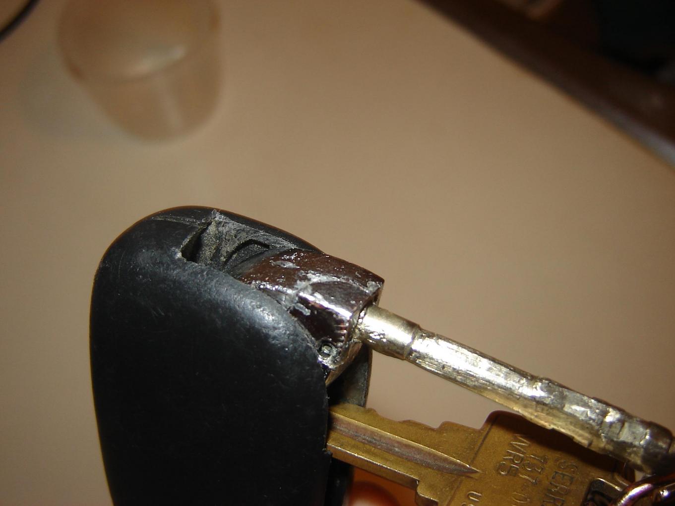

I managed to get the doors unlocked! My coworker used some industrial strength glue to put the blade back in the key fob. I attached 2 pictures to show you where my key broke, and how worn out the key is. It's like the key was made of clay. Anyway, I'm probably going to reinforce the key by gluing it opened permanently. The action of opening and closing the switchblade puts a lot of pressure at the joint where the key and fob meet anyway. This won't solve all the problems but it gives me more time to find a locksmith, get a new key etc.

I decided to use more glue (Loctite 444) to permanently keep the switchblade opened. I don't care about folding the key in (which itself puts stress on the housing for the blade). The car started without any security issues since the transponder is obviously not in the blade. The ignition does not stick nearly as much as the doors so I'll try not to lock the doors to often for now.
