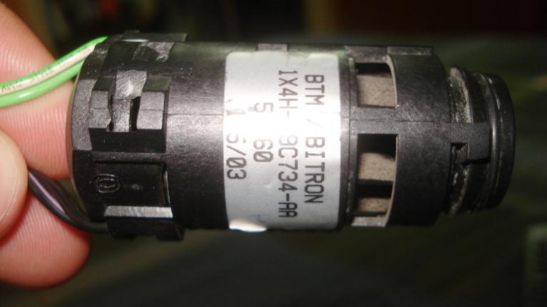

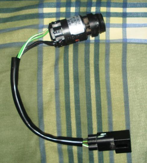

2003 X-Type indoor air sensor wont turn off. What do I do?
KXUNA, if you look at the sensor, it will have a white/red lead and a black/white lead. The white/red lead is where power comes in and the black/white lead is switched by the A/C control module. So, odds are, what you will need to do is disconnect the plug from the A/C control module and see if the fan continues to run. If it don't, then you are looking at a bad A/C control module. If the fan continues to run, then you have a wiring problem.
If you need more help, let me know and I will go into more detail about this.

To solve the problem temporarily I already disconnect it from its first wire connection on the wiring harness just like shown in your pics but obviously if I disconnect it from the power source entirely it won't run.
Is the A/C control module juncture more towards the back of the AC unit where it will still have a power source and try the wiring test?
The AC/heater seems to work fine with out the part but probably is not reading the indoor temp.
