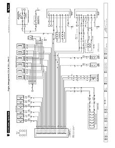

does any one have the wiring diagram to the coils and information on how to check the crankshaft position sensor?

Elect Diagram for the coils circuit - MY2004.25 (Note - 21 II in the center of the diagram is the supply from Fuse F10 to the coils). Click on photo once to enlarge - click on the enlarged photo to zoom.
