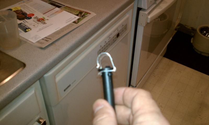

Last night I discovered a flat on the rear driver wheel. At a -15 degree F wind chill, I spent what seemed to be forever to remove the 18" BBS wheel/rim off the car. The wheel would move about 1/16" when I move it, but it would not come off over the threaded studs until I played with it until I lost feeling in my finger tips.
Brought it into the kitchen to find a tiny slash usind Windex as I couldn;t find a typical nail or screw.. I used a plug-in strip to seal it. I had a medical appt in AM and didn't want to mess around as I'd prefer a patch inside the tire. I kept the wheel in the house over night and it slipped right on this morning. Does anyone spray anything on the metal around the wheel studs? I noticed a lot of rust & have had problems in the past with other vehicles which the wheel has rusted to the axel.
