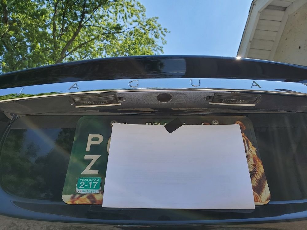

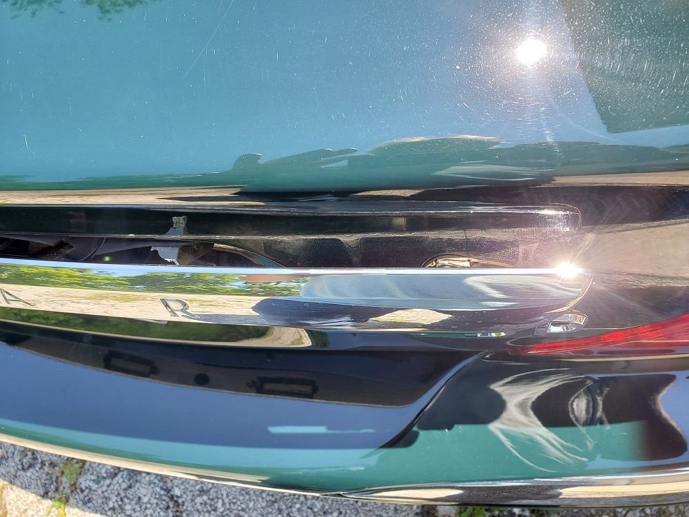

My Wife has a 2005 X-type VDP that I need some assistance with. This is an all original car, After attending a show over the weekend we noticed that the boot rear chrome plinth was broken at the holding tabs as if someone had forcefullty pulled doen on it. I now have to replace it. Replacement seems pretty straight forward. The issue is locating it. Have found several for the non VDP but the boot release button is on the face where ours is underneath between the liecense plate lights, Does any one know the part number for this piece, Or supply a assembly diagram for the removal and installation og the new piece.

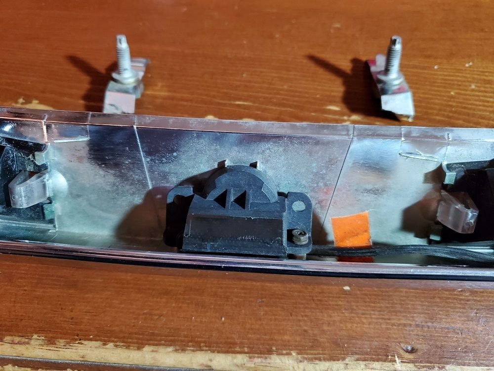

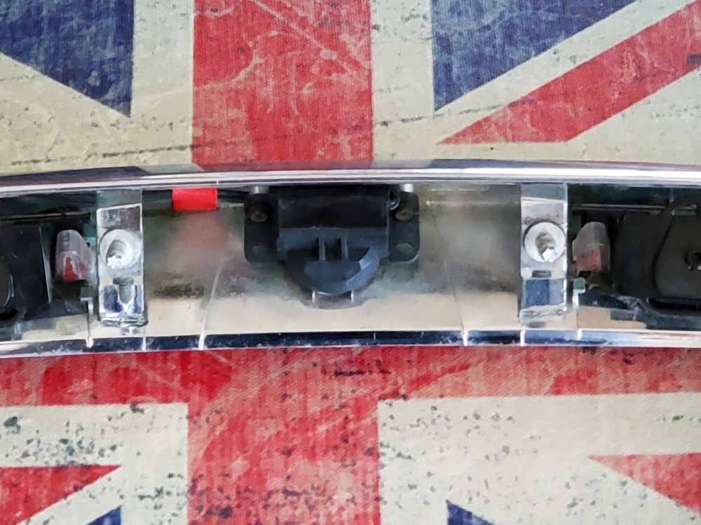

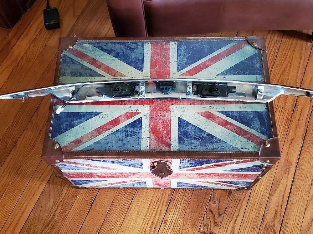

Having spent 7 years restoring a 72 Oldsmobile owned by my Father i have become pretty proficient in repairing plastic parts. So I was able to rebuild the plinth till I can locate a good affordable new plinth ! should hold well as long as the trunk doesen't get slammed. Here are some of the repair process pictures. by the way Welsh.net helped me by providing the correct part number #C2S38525 is the proper number for the plinth with the boot release button underneath.

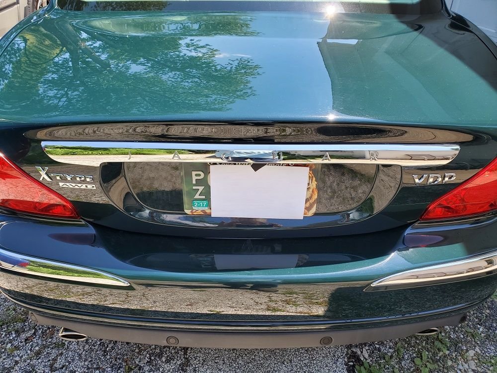

So aside of missing a small locating tab on the outside passenger side, everything is back together for reinstall ! Wish me luck hope all holds together ! I thank you and my sidekick thanks you for all your assistence and input!

Got everything back together today ! Most of the clips held but I think one of the center tabs snappped loose again. But things are holding tight till we find an intact one for an affordible price. Sorry mini me photobombed me just as I was taking the picture ! LOL
