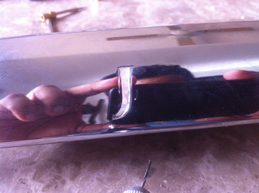

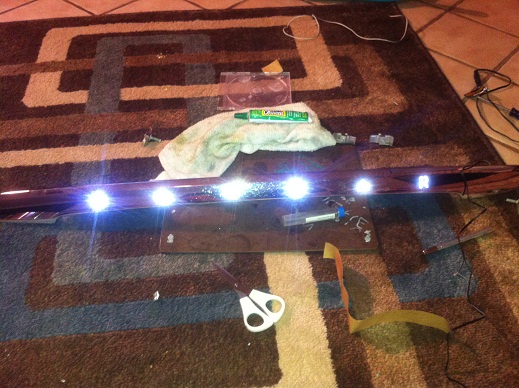

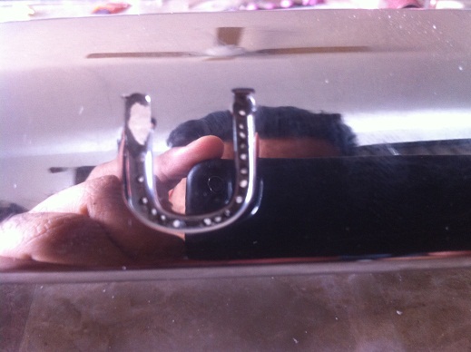

I didn't take a lot of pix but will upload what i have. I'm not sure if you can do this if you have a 2.5 since the ones i've seen around here have the trunk button on the back part and not underneath the boot plinth. But what i did was remove the chrome part (do this very carefully cause i broke all the screws that hold it to the frame).
I also bought a detail hand saw ( like a mini rotozip at harbor freight only cost me $10! ) i went ahead and drilled into the letters carefully and then grinded out the lined area.
After all the letters were done, i bought an LED white light strip ($39.99) and gorilla glued it to the back.
i tapped into the licence plate light wire ( the right side light ) so when i turn on my headlights, it lights up.

My other concern with it is water sealing...I suppose you could use some silicon before applying the leds to the back to make it water tight and use some waterproof sealed led's from the get go...

Well to answer the "?" About the water seal, the LED strip is for outdoor use and I just used the covers the came between the body and molding. I'm glad everyone liked it and I also posted a while back the side mirror LED mood. I put a strip of amber LED's behind the mirror so the turn signal glows behind the mirror.
