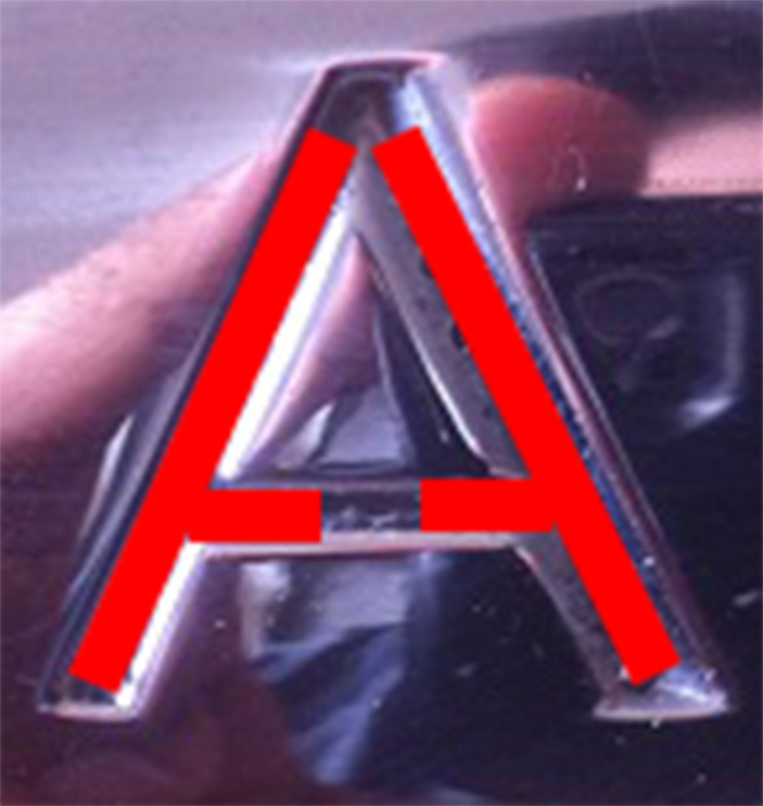

But could you let me know how you did the A

i just left the top of the "A" and part of the middle ( attach is the image with red line on what was cut out)
