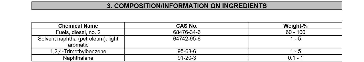

A review of the Techron MSDS shows these disclosed ingredients:
As far as I have been able to determine, none of the disclosed ingredients would be classified as a polyether amine, so that ingredient must fall into what Chevron calls a "trade secret," and is therefore not included in the MSDS. But it was the apparent effectiveness of this ingredient that led the BMW engineers to approve Techron for use in BMW dealerships.

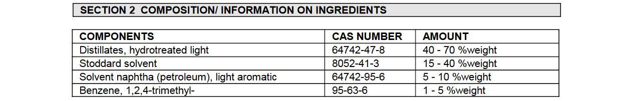

It is interesting that the composition of Wynn's Fuel Injector Cleaner, which is recommended by Jaguar, is similar to that of Techron, except Wynn's missing "trade secrets" are apparently polyisobutylene amines, according to one of their product sheets:
Here are the disclosed ingredients of Wynn's:
