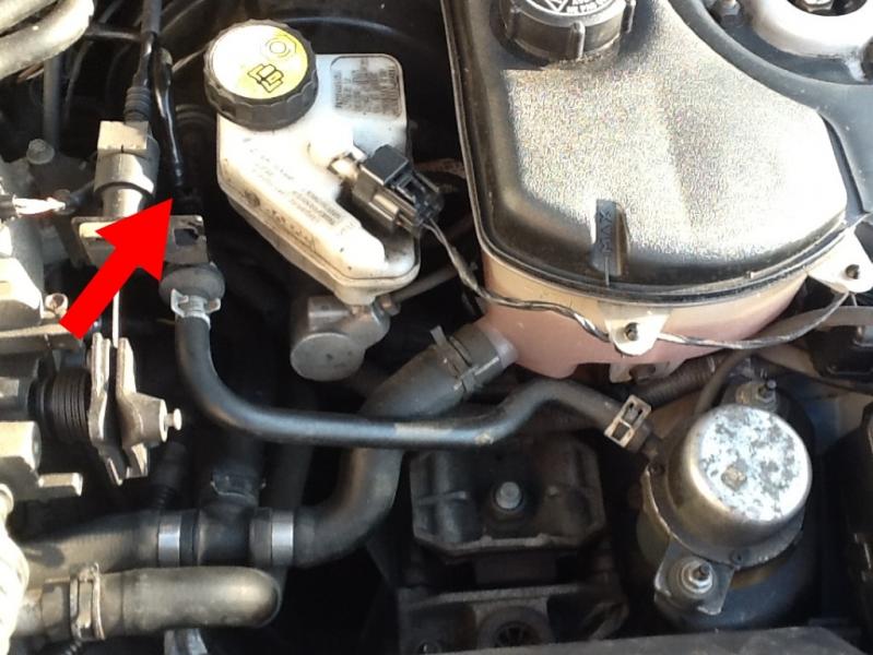

I have found the problem , when I was removing the rear bolt from the starter motor I have snapped a 'T' pice on a pipe which is some how connected to the braking system ,I hope it's an easy fix I can do myself
I have posted a photo to see if I can get any advice on the issue

I belive it now comes of the (Air vacuume pump brake master cylinder)
