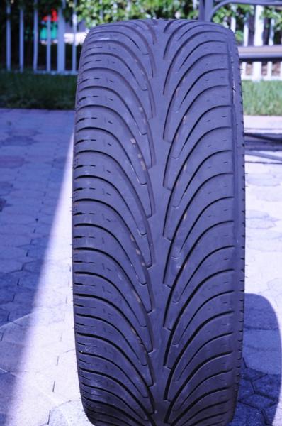

Hey Brutal...thanks for the info.
Could you please take a look at the attached photo of my tire??
thanks...d

well personally, i would increase toe in and check deflection while on the alignment rack to see how much the suspension moves (toes out). too many tech would never think about deviating from factory specs. They expect the machine to be the end all. To me the tires are the end all. Theyre telling the story and you have to use experiance and the before alignment settings. tire wear and make a determination on the BEST course of action. An alignment is a compromise. there are trade offs. Most want a straight driving non tire wearing alignment. Then there are those that want the most grip in high speed cornering. Some want faster quicker turn in, or high speed straight line stabilty(drag racing) they all have trade offs. But for most all communters and striaght car that doesnt wear tires( I llaugh when people say" I dont need an alignment, my car goes perfectly straight" well that may be, but your tires are showing cords inside
