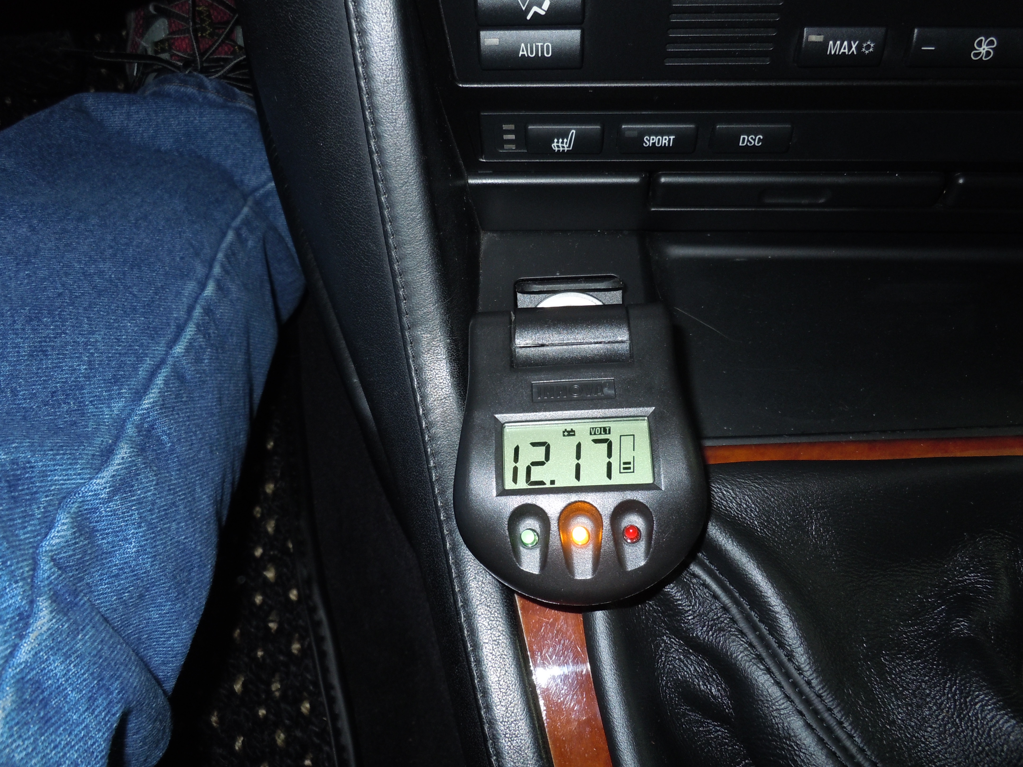

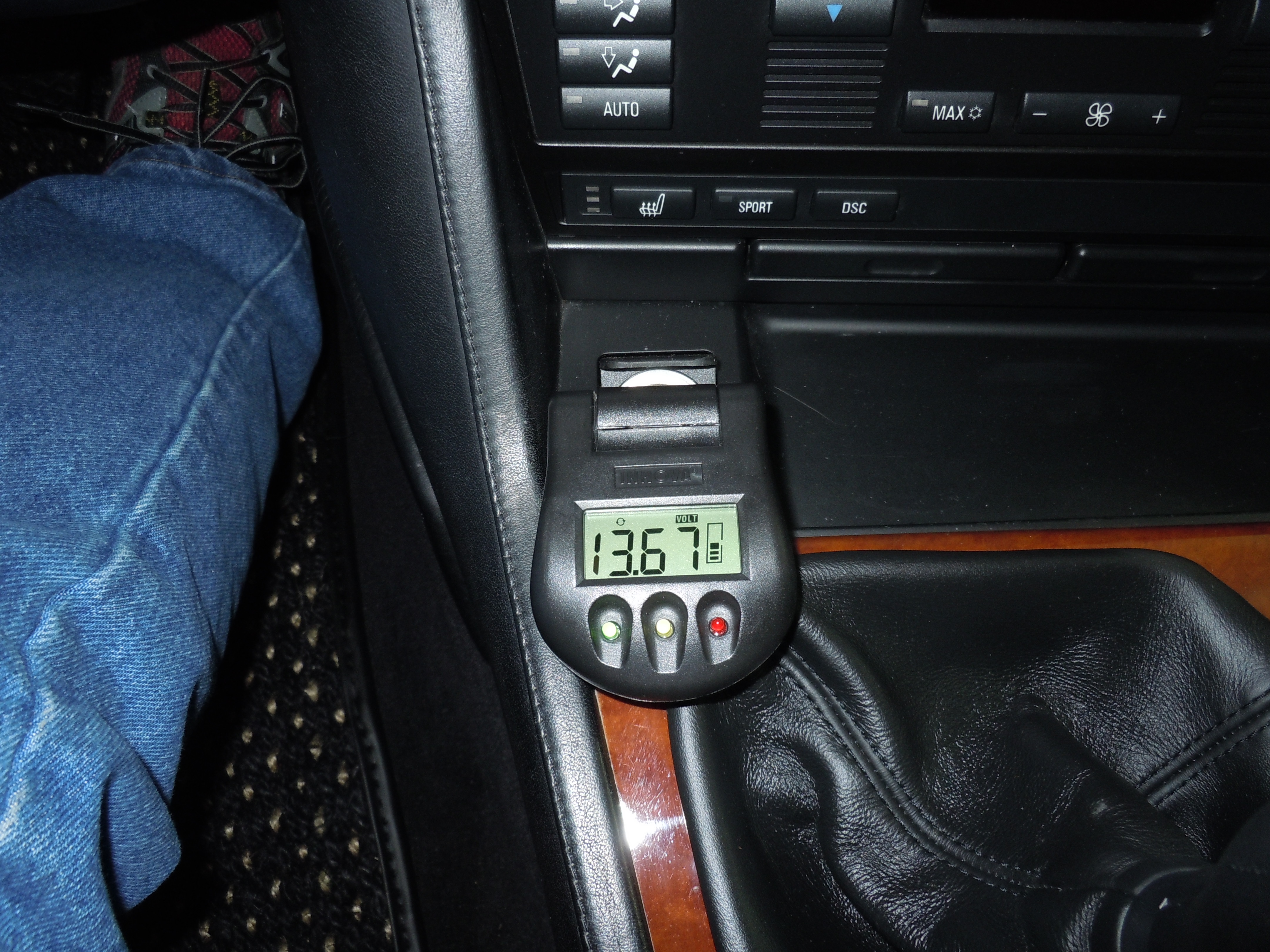

Here's a handy inexpensive tool I bought from Amazon. With it you can easily tell battery and alternator condition from driver's seat. Shows static battery charge before engine start, then alternator voltage afterwards.
Attached Thumbnails Alternator overcharging?-voltmtr.jpg   Alternator overcharging?-voltmtr1.jpg   Alternator overcharging?-voltmtr2.jpg
