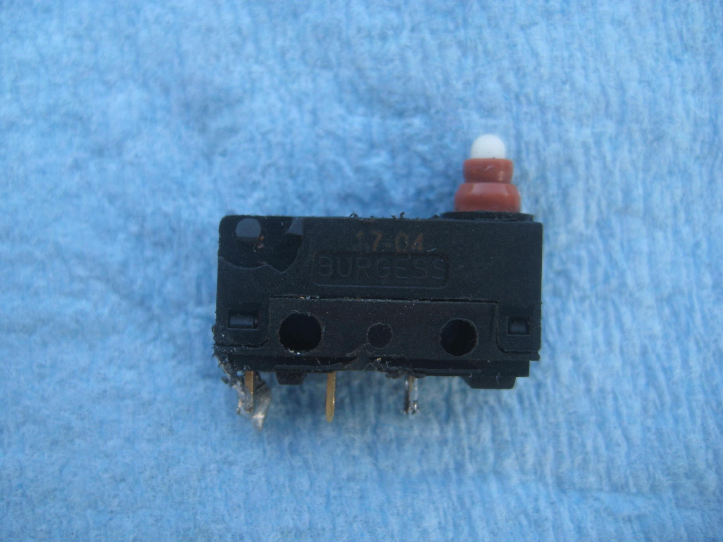

Thanks Stuart, got the micro switches you sent me and pulled my shifter apart today to fix the constant clicking every time I stepped on the brake.
My shifter only had one micro switch in it and it was bad, it would open the circuit normally but when the contacts closed (in park) it had about 4 ohms of resistance and I guess that was enough to keep the circuit from recognizing that it was in park. This kept the park lockout function from working (you could take it out of park even when the engine was off and foot wasn't on the brake) and the solenoid clicked every time it was in drive and you stepped on the brake.
Replaced the switch and all is good again. The new switch didn't have a plunger, it had a long metal lever on it that I had to bend/fold over into a triangle shape to get it to work correctly but it worked perfect after a little trial and error.
Thankfully with your help, I now have one more minor but very irritating problem solved.

If anyone wants to do this repair, I'd recommend that you try and order a micro switch that looks like this.
The one's that I thought I needed that Stuart sent me (Thanks so much Stu you rock!!) worked ok after some fiddling but having learned from my mistakes; it might be better to get the exact replacement one rather than having to bend the metal actuator arm of the N97AQ switch from a flat bar into a triangle to make it work.
Attached Thumbnails Anyone have an extra J-Gate micro switches-j-gate-micro-switch-1.jpg   Anyone have an extra J-Gate micro switches-j-gate-micro-switch.jpg
