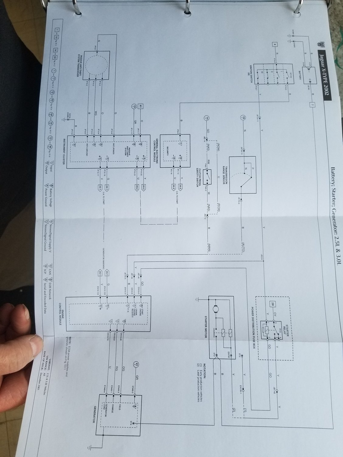

I got codes read on the car and its p1146 (Generator C line low input) does anyone know what color that wire is? This is the wire diagram
