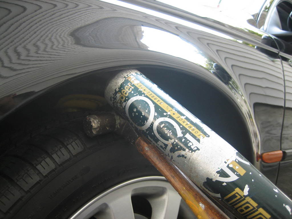

Ok gents, crappy pics, successful fender rolling.
I wedged a hammer on the tire, and put the bat on top, forcing the fenders up at an angle This is a recreation, i wrapped the bat in a tshirt in the actual work. I used a heat gun for about 40-50 seconds per 6 inch section.

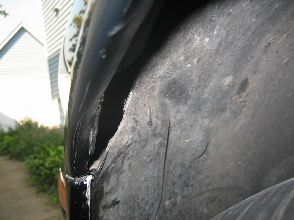

here is before
here is after. The pic really doesnt show all that well how much i folded the lip back, but its went from flat to about 80degrees up, the plastic wheel well was also pushed up and hopefully out of the way completely. In the pic, it looks like a scratch, but its just the flash from the camera, I actually made no scratches at all, and no cracks in the outer quarter panel.
The only thing left to do in front is trim about 1/2 an inch from the bumper...the white part in the last pic b/c that little tip is what actually causes the most damage to my tire (rips in the sidewall) Im putting the 18s back on tonight after work. sorry abot the crappy pics

AWESOME job man! The best I've seen without the proper tools! MORE PICS! The paint stetched nicely as well!
