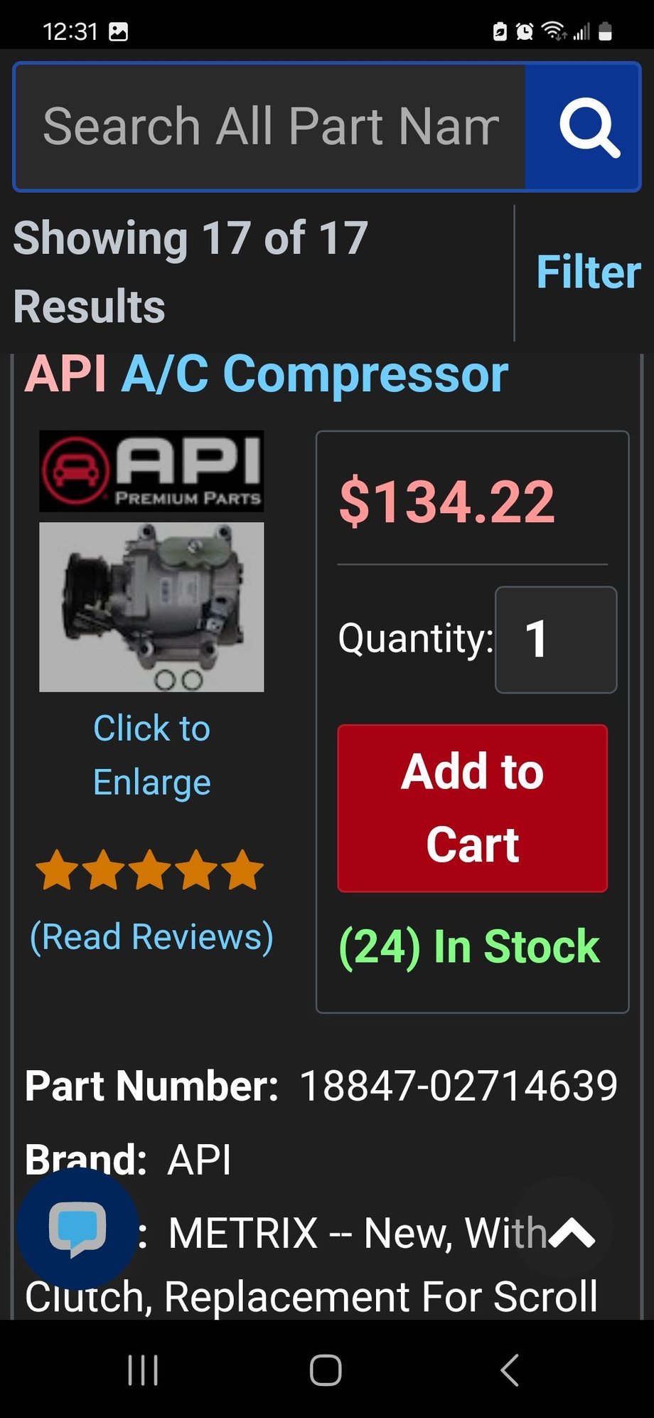

I bought mine from Parts Geek to replace last fall, but ran out of time. Going to do it this summer. WAY,WAY less cost than your 2 amounts.
Compressor only, kit, and kit with condensor.

Motorcarman's first reply is a list of aftermarket compressors that work in the X-Type. i.e. "gpd 6511486" is part number 6511486 from GPD (Global Parts Distributors). Currently for sale at $205 on Amazon. The point being that a Jaguar branded air compressor is not required and is probably unnecessarily expensive for a replacement part.
