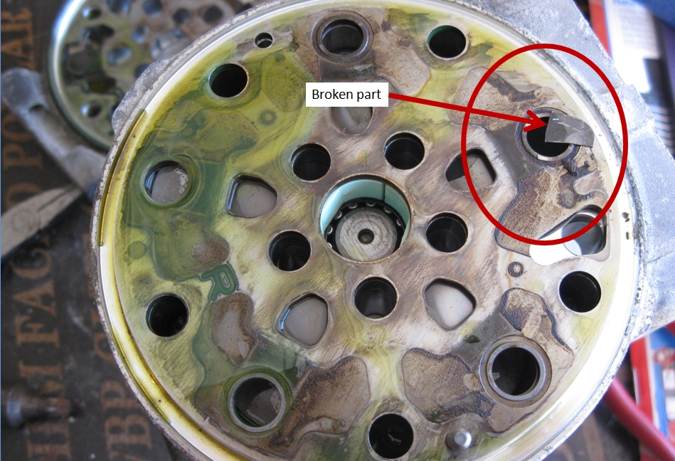

Attached Thumbnails Source for A/C Compressor-img_2509-2.jpg
