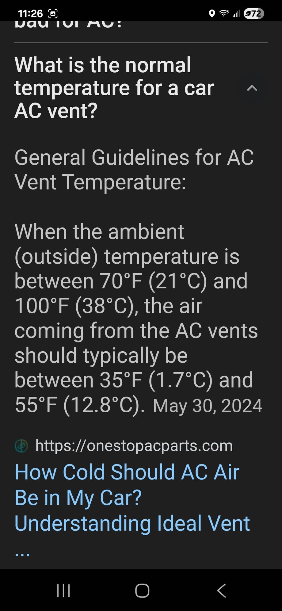

Is the x-type supposed to blow between 30-40F at the vents? Has anyone measured their lowest vent temperature?
My a/c is blowing out from vents between 12C-14C or 53F-57F so sounds like it is a bit warmer than it should be.
Mechanic recently changed condenser as it was leaking. He agreed it should be a bit cooler around 5C-7C or 41F - 44F.
He is suggesting changing the compressor and receiver/dryer but cannot guarantee a/c will blow any cooler.
Any thoughts or advice?
Thank you in advance.
